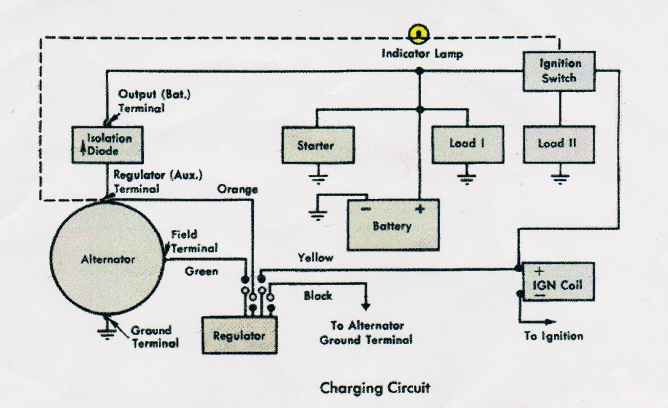

if i had a diagram of how it was supposed to be, i would be set. Not the easiest thing to come by, particularly when I am not even 100% sure of what tractor I have.
The key switch applies 12 volts to the yellow regulator wire in the on position
The charge light wire terminates on the alternator 9 oclock position in your picture with the red or orange from the regulator
The green field wire from the regulator terminates on the brush connector on the alternator (12 oclock in your picture)
this might get the system up and working
