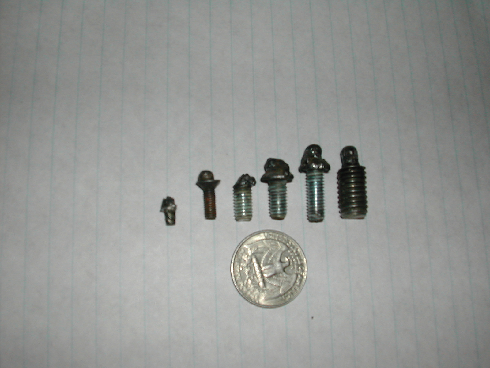

OK, just because I guess, if I can attach the photo
The left side is somebody's easy out end..... got to love those
Next is a 4mm cs screw, out of an aluminum housing
6mm stud
2 6mm screws
An 8mm stainless stud from a volvo penta outdrive, broken 1/2" down into the hole of the aluminum outdrive.
When you heat (weld) on the bolt, it tends to expand and contract and break the "bond" between the fastener and the hardware.
Does not always work, but if I only had one shot, small fastener, that is where I would go.
If you do not think aluminum is magnetic, try drilling a hard steel small bolt out of a chunk of aluminum and see if your drill bit is not powerfully attracted to the softer aluminum :)
Good luck getting your bolt out.
