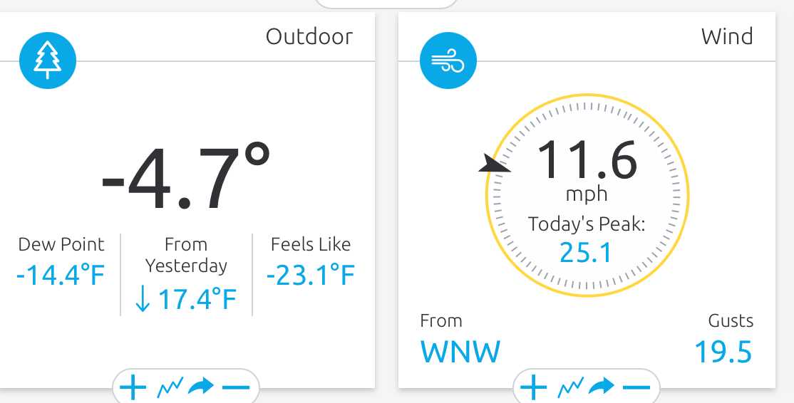

/ Extreme cold #25
well if its a competition -27.4F ''feels'' like -50.8F
below in Celsius
/ Extreme cold #26
Fair
-33°F
-36°C
HumidityNA
Wind SpeedW 6 mph
Barometer30.50 in (1038.7 mb)
DewpointN/A
Visibility10.00 mi
Wind Chill-51°F (-46°C)
Last update23 Jan 4:54 am CST
