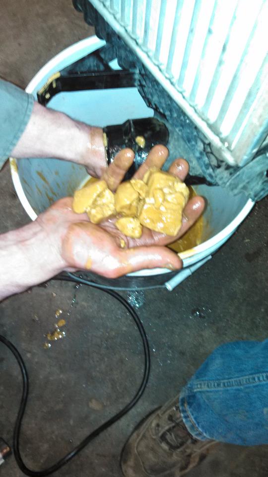

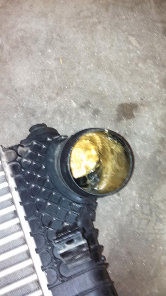

There is one serious issue with the Ecoboost that is causing quite a bit of warranty and performance issues;
   / F-150 Eco Boost Towing Vs Nissan Titan #95
Looks like a radiator/cooler problem, but Im not familiar with the chunking.
Also - matches line 3 of my post 92. Par for the course.
UD
   / F-150 Eco Boost Towing Vs Nissan Titan #96
What the heck is that?
I've heard one owner complain about a broken motor mount, but otherwise mostly positive.
It's ice mixed with a little oil blocking the intercooler. Anyone who drives these trucks routinely at or about freezing when it's humid should be aware of this. It takes out the cat(s) when it thaws. There is a TSB on the issue and a intercooler design change to try to minimize it. Same thing happening with the newer tdi VW's that use air to air intercoolers. In VW's it will hydrolock the motor....
<img src="http://www.tractorbynet.com/forums/attachment.php?attachmentid=311720"/><img src="http://www.tractorbynet.com/forums/attachment.php?attachmentid=311721"/>
What do you mean "serious issue". Never seen or heard of this happening and i am on a lot of forums. Please post the source for these pictures so we can see the whole story.
I have heard of the condensation issue with the tsb but this looks fishy.
