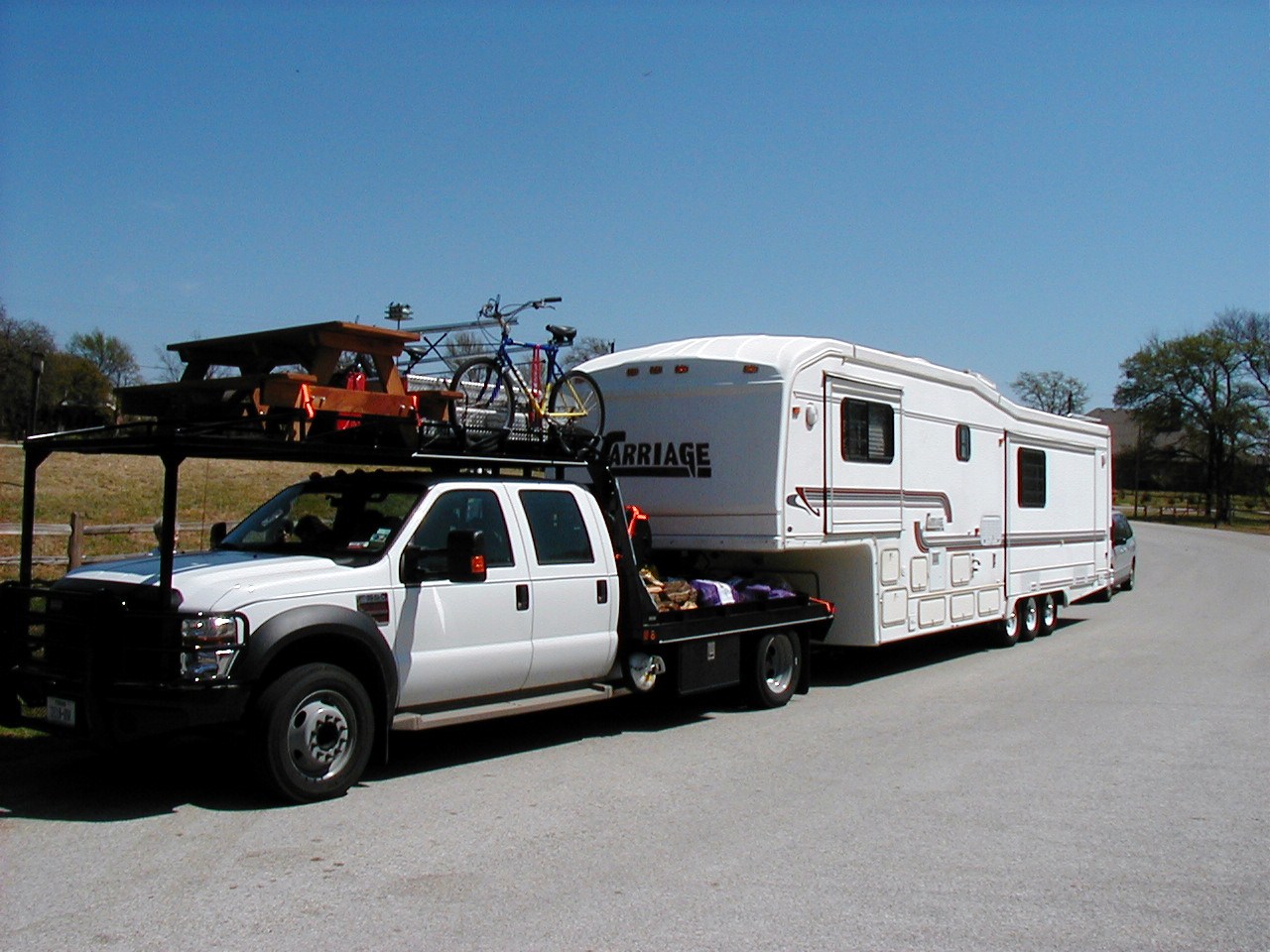

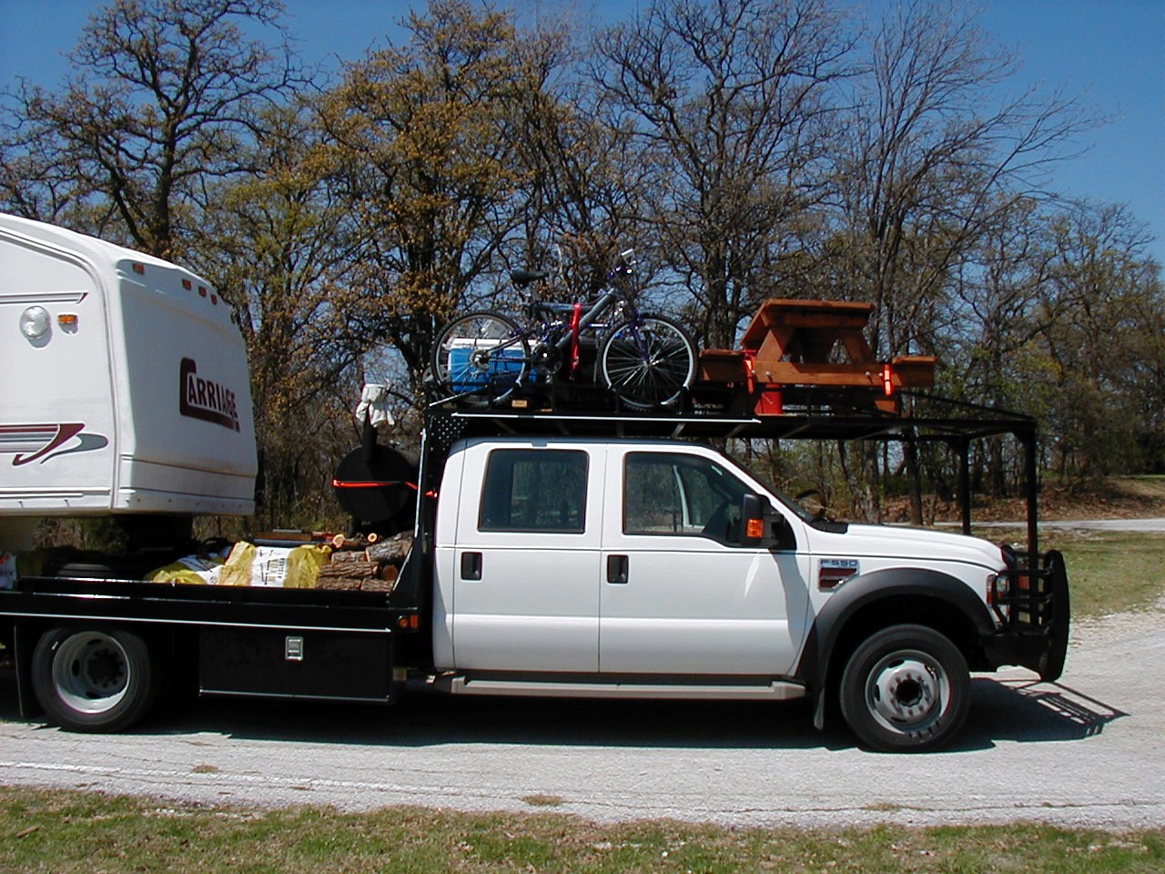

One of my brothers has a 2008 F550 crewcab, long wheelbase, 4.88 differential and loves it. Plenty of power for pulling a load. He and his wife spend the winters in Texas and summers in Washington state. He was a little concerned about the diesel fuel getting into the crankcase, but even my Ford dealer's service manager says all the 6.4L diesels do it; just some more than others. And yes, fuel mileage is not very good, especially if you're pulling a load as you can see my brother pulls. However, they recently had some program (they didn't call it a "recall", but something else) where they re-programmed the computer and it's supposed to help with the mileage and fuel in the oil problems without hurting the power.
Of course my brother (and some others I've spoken to) say you want to be sure and keep an extended warranty in effect because if they ever have to work on that engine, they have to lift the entire cab off the frame to start with, and while that's relatively simple on most of them, it's also expensive.
