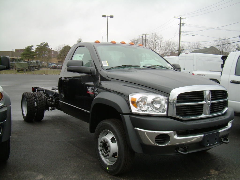

My 3500 Ram (12,500# GVW, 23,000# GCWR) cab/chassis is rated to pull a 16,000# trailer with a class 5 (f-550 or 5500 class) 6 speed auto tranny (with a 180,000 mile warranty) with tow haul mode. Big rig in-line 6 cylinder with integrated variable geometry turbo (engine brake)
Look into Dodge, it'll get it done, just have a high limit fuel card on you!
I heard parts for the class 5 trucks are off the charts dollar wise!
JB.

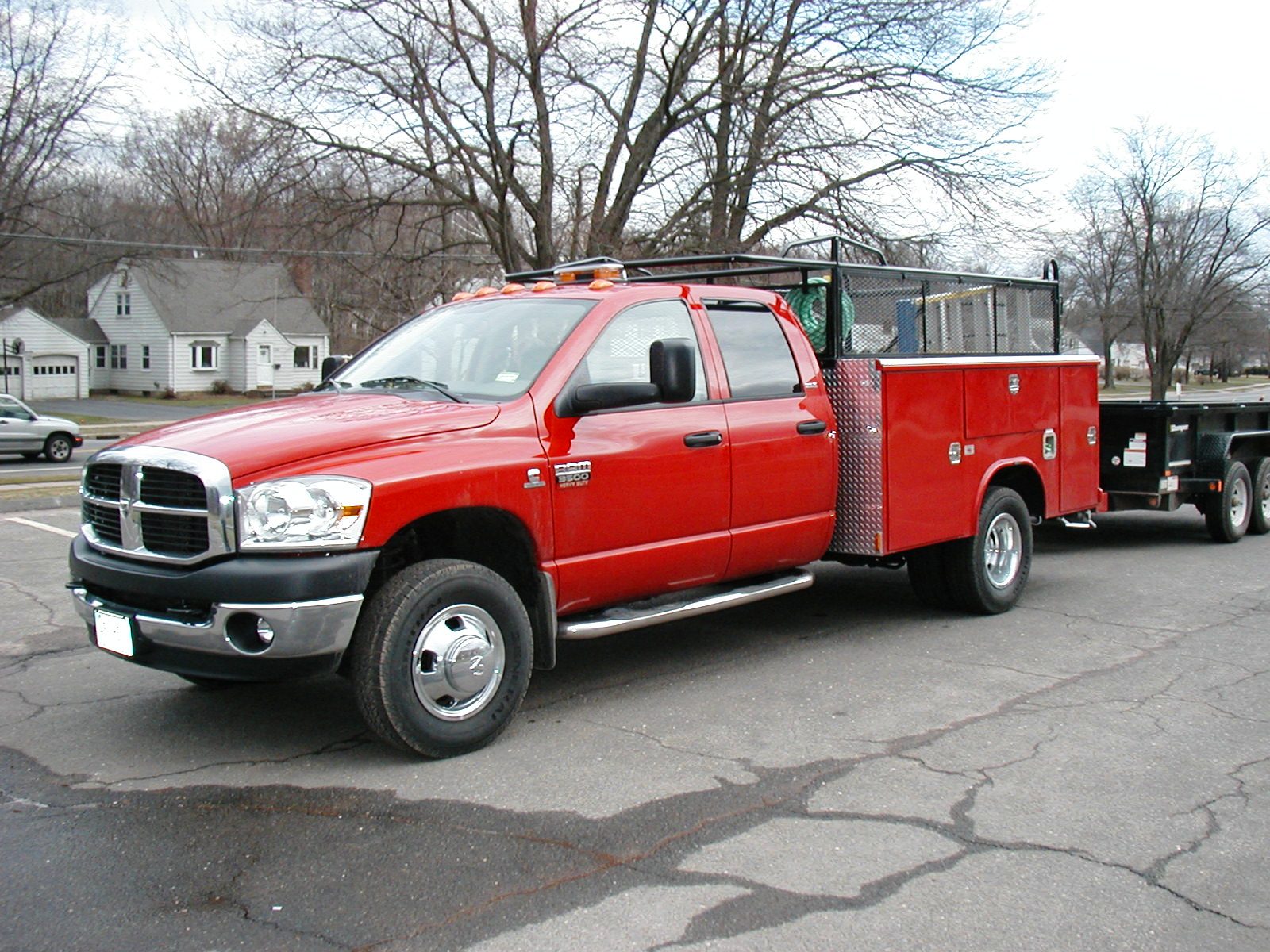

I would like to hear any opinions you may have on Ford's 6.4 diesel and / or 2008 F-550s. I am thinking of trading in my F-250 and purchasing an F-550.
SouthernX,
I have a 2008 F-550 with the 6.4L engine and 4.88 rear end. I only have 5,200 miles on the truck but have not had any issues to date. The truck averages between 7 and 8 mpg. Last week I pulled a 32' trailer (GVW was around 37,000#) for 250 miles on the highway. I checked my mileage when I got home and only got 6 mpg:eek: I went through both fuel tanks on the trip home.
Nobody has commented on the difference in the undercarriage between the F-550 and your current F-250. Everything is twice as heavy-duty under my F-550 as my F-250! Looks like a tank under there! I agree with other posters that a 3/4 ton or 1 ton truck will pull heavy loads...but will they stand-up to the regular pulling of such loads? When you crawl around under the F-550 it is obvious the truck was built to work.
I knew my GVW would regularly be over 30,000 lbs. therefore I bought a truck that would withstand that type of abuse. Go to a dealer with F-250s, F-350s, and F-550 and compare everything about them. You'll see what I mean.
Hope this helps.
