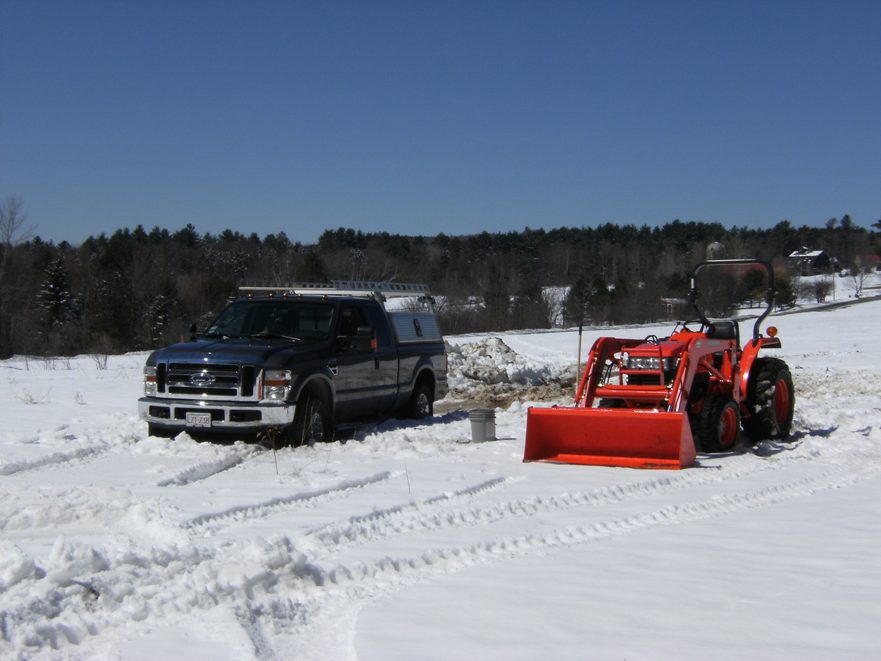

I have an 08 F-250 supercab 4x4 with the 6.4L It now has over 20K on it and
average MPG's are 14-15 thats used solely for buisness and is run in the Mountians of W. Mass and Vermont.
Empty at a 55 mph it gets better then 17, sightly less at 65-70 which is were I usually drive at high speeds.
Towing various tractors mostly in the 10-12k range still averages 14
I frequently tow to Northern VT on the Highway (which is like a roller coaster ride) 200 mile trip and still average around 14 mpg
What 1 poster says about the boost is true, you peg the boost and the MPG's drop.
