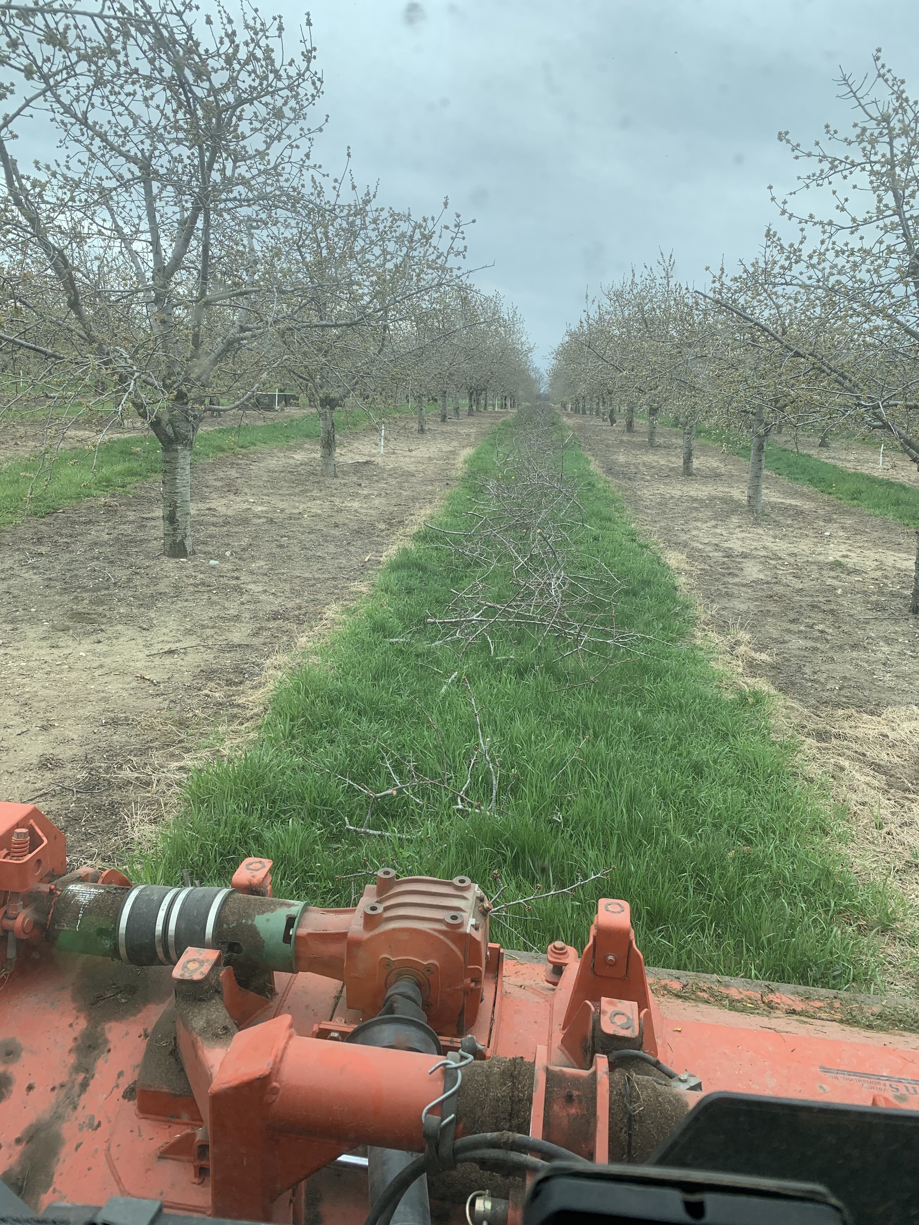

There’s so many aspects to growing high quality fruit trees it’s hard for me to even know where to start. First thing I think it’s very important that you get your private pesticide applicators license, without it you don’t have access to the spray materials you’re going to need and the knowledgeable people that sell them.
Do you have any way to weed spray under your trees to eliminate the competition for water and nutrients that they impose.? If not how much of that 1000lbs of fertilizer you bought and spread did the trees get and how much did the weeds steal? Same with rainfall, are the weeds sucking up the little bit you got and robbing it from the trees? Maintaining a clean orchard floor under your trees is important to maximize the nutrients and water that is available to the trees. You’re going to need a license to buy the best herbicides.

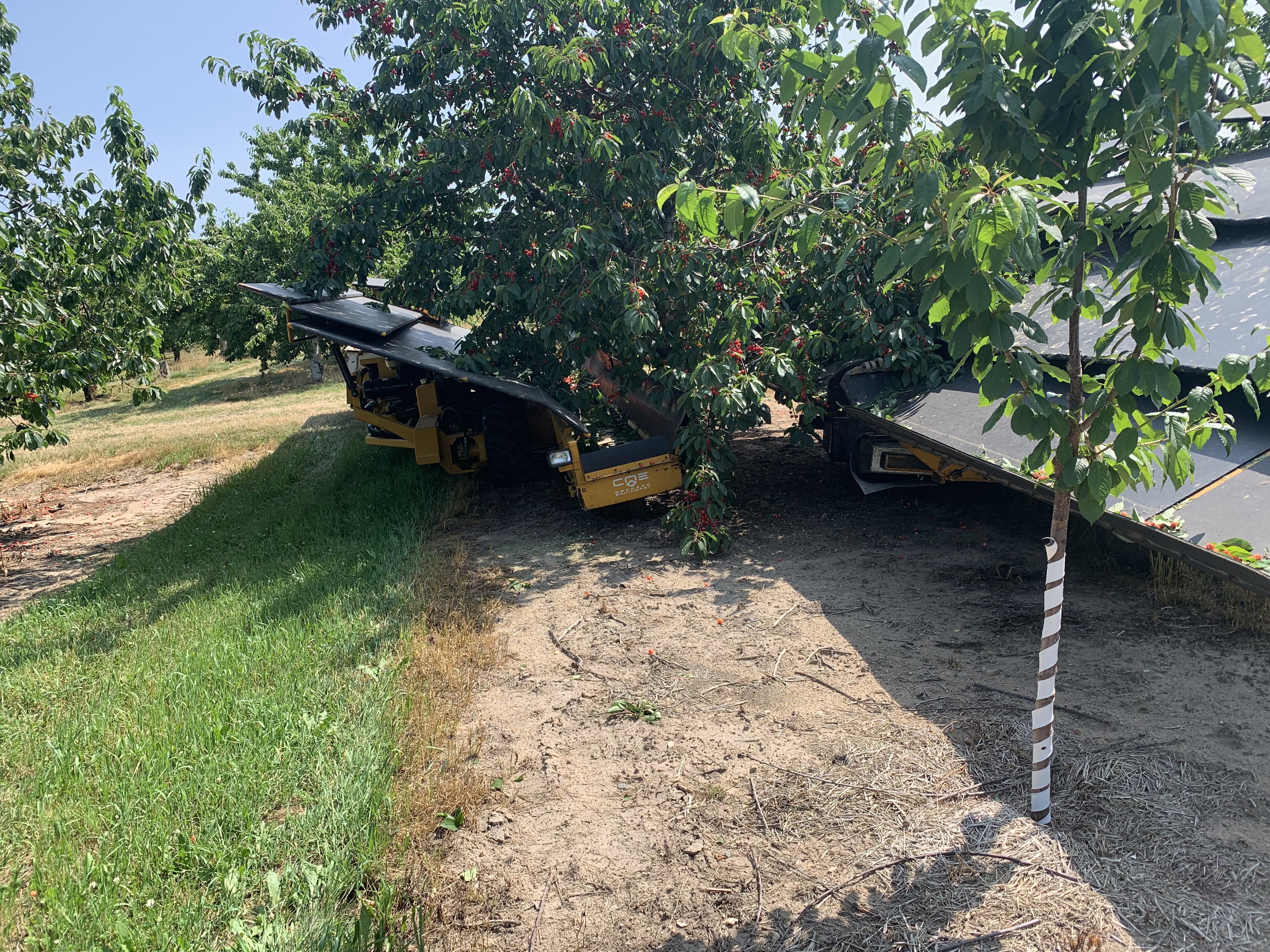

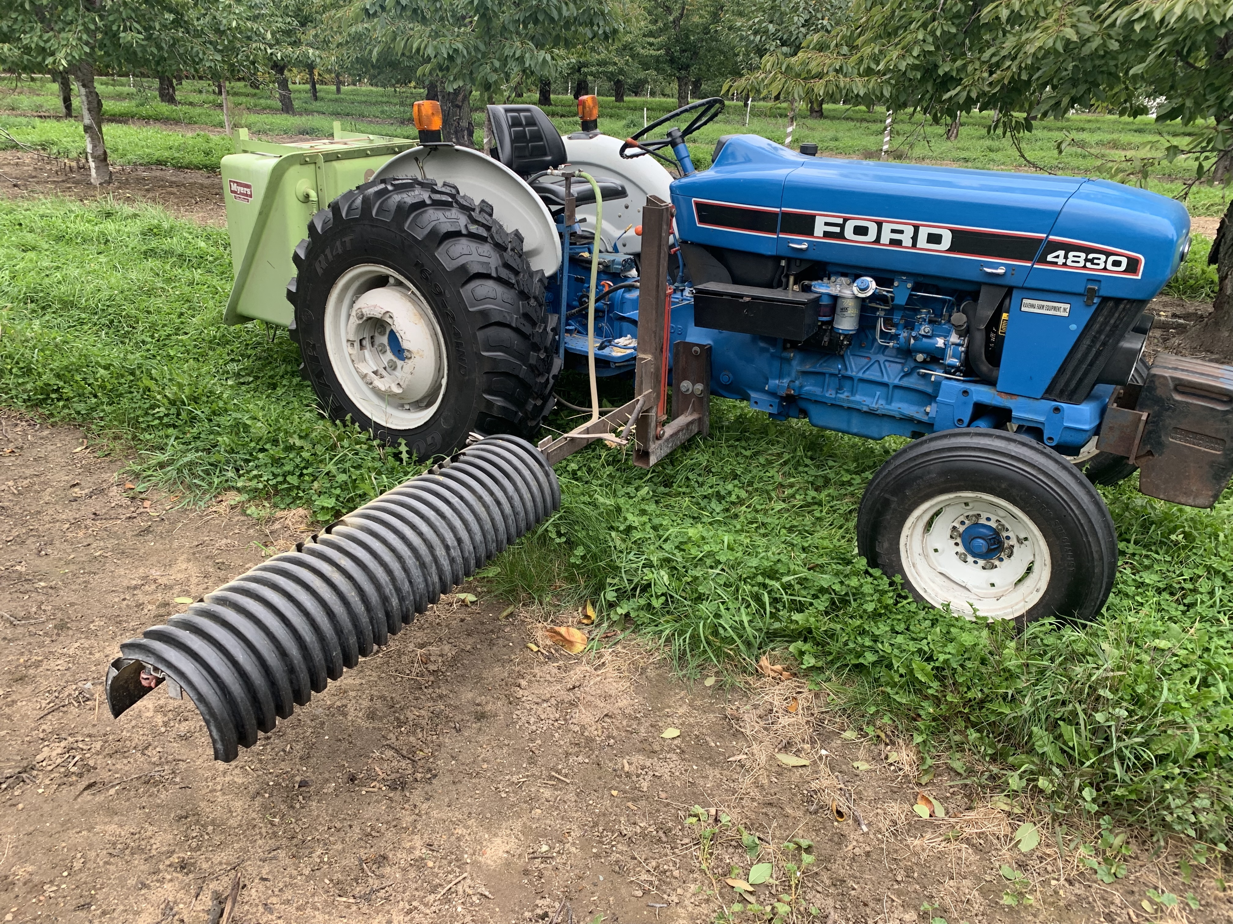

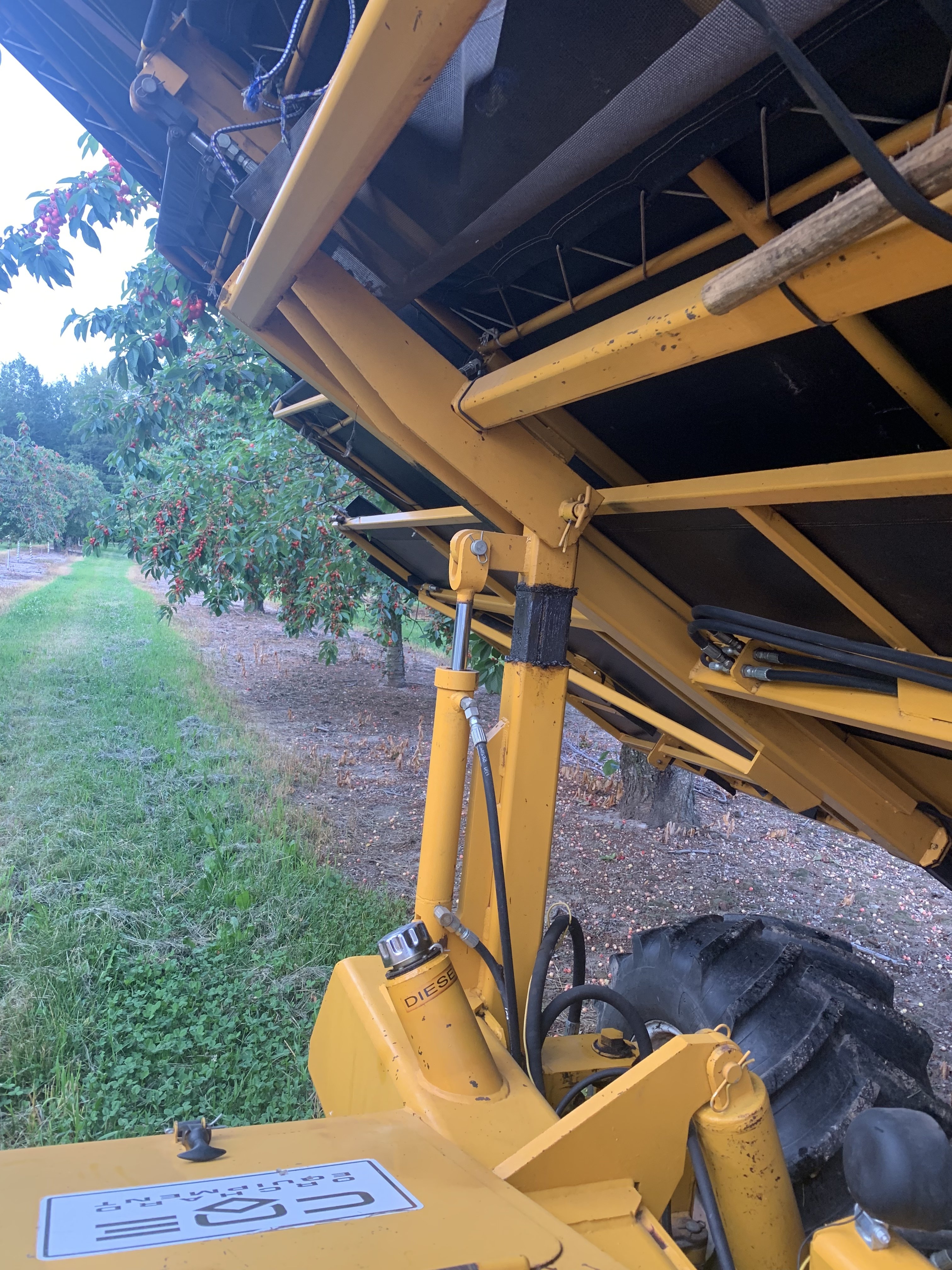

Few pics of what my orchard floor looks like
