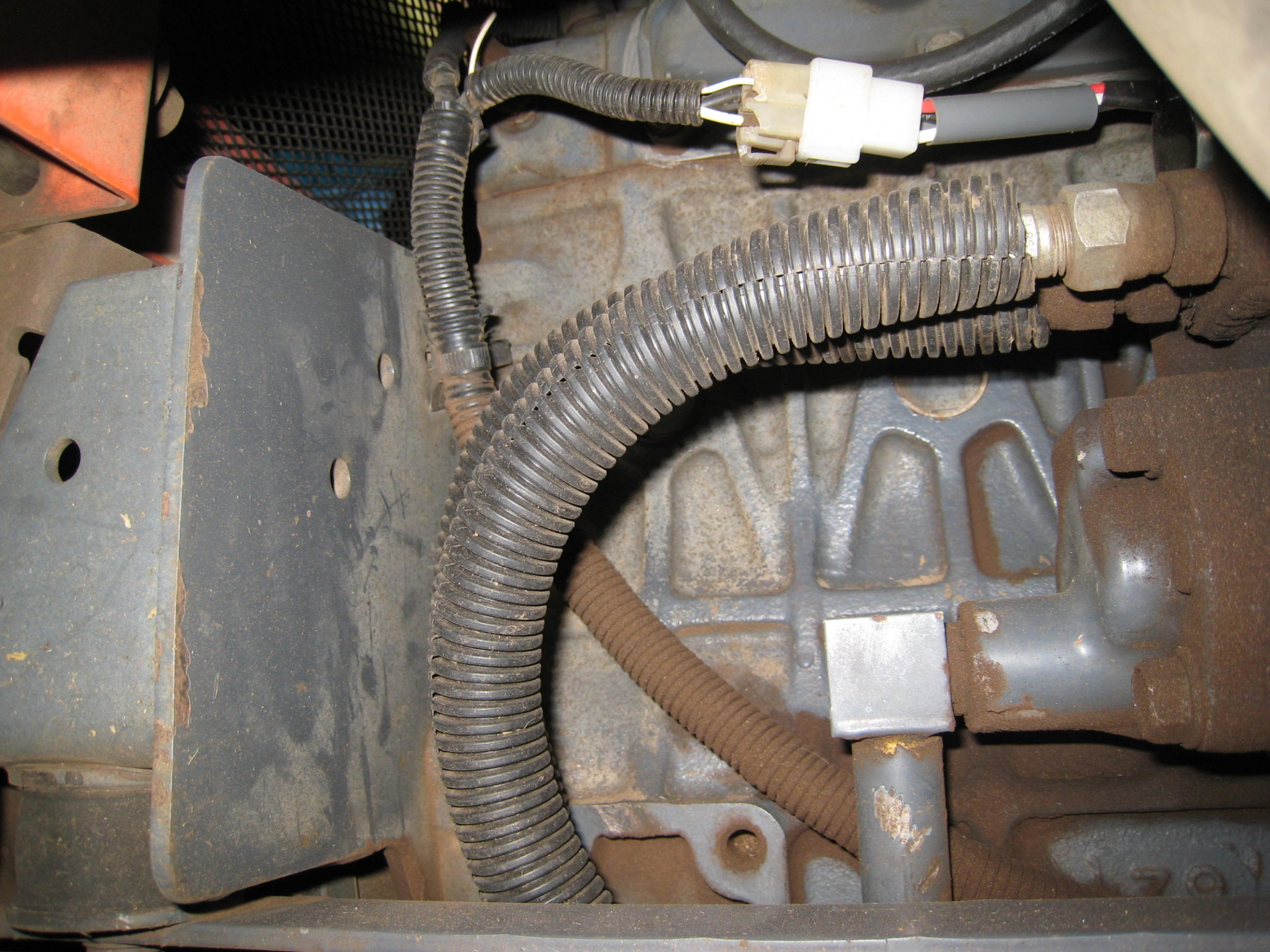

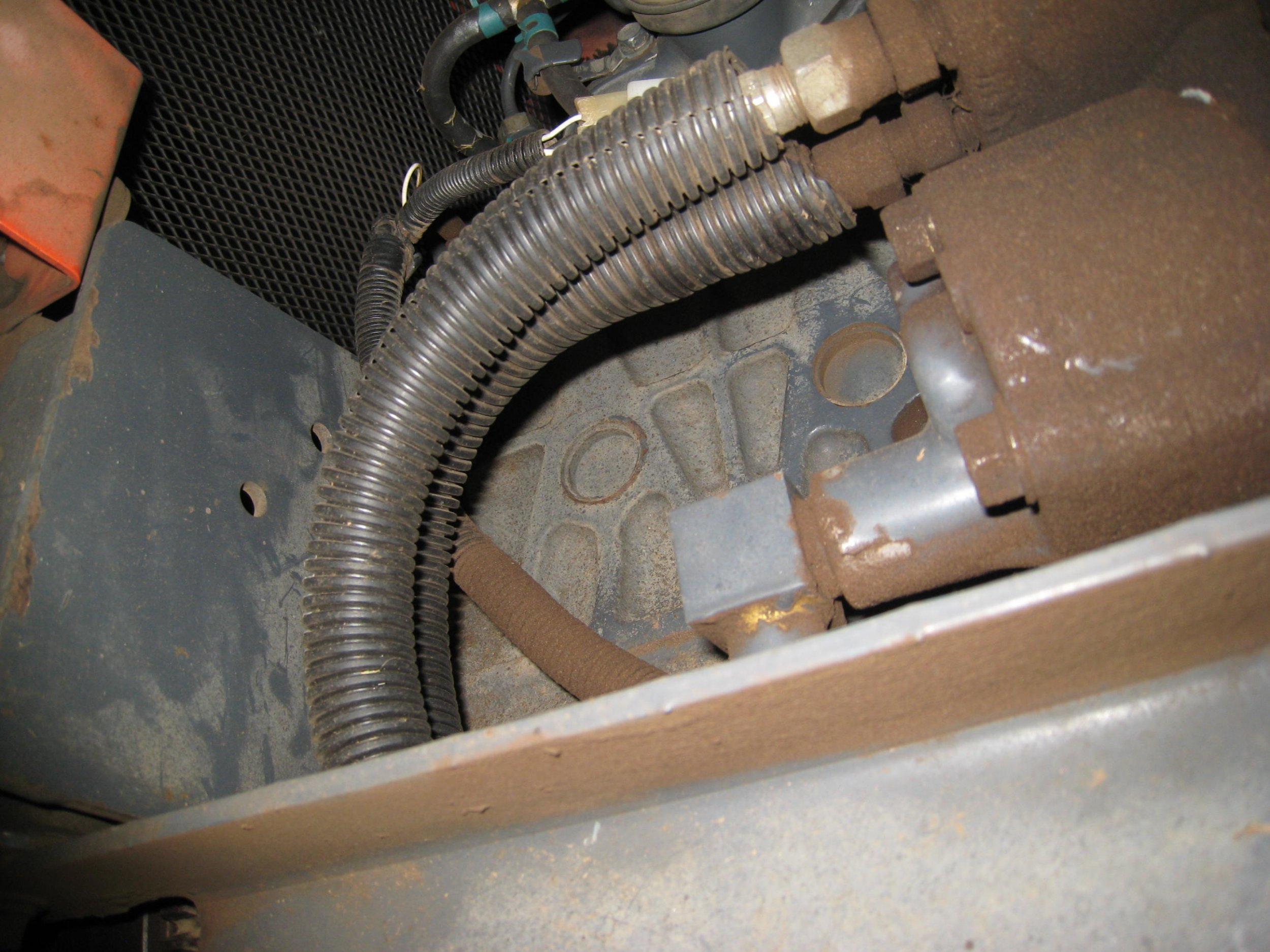

Wow that was a quite a leak and made a mess - hopefully you can figure a permanent solution.
I got little concerned and just went out to check my F3060 which has a 4-cylinder 30 hp V1305-FM engine and looks like it does not have an opening for a plug in that location.
It's due for valve clearance check soon so I will make sure to inspect the crank case ventilation while at it.
