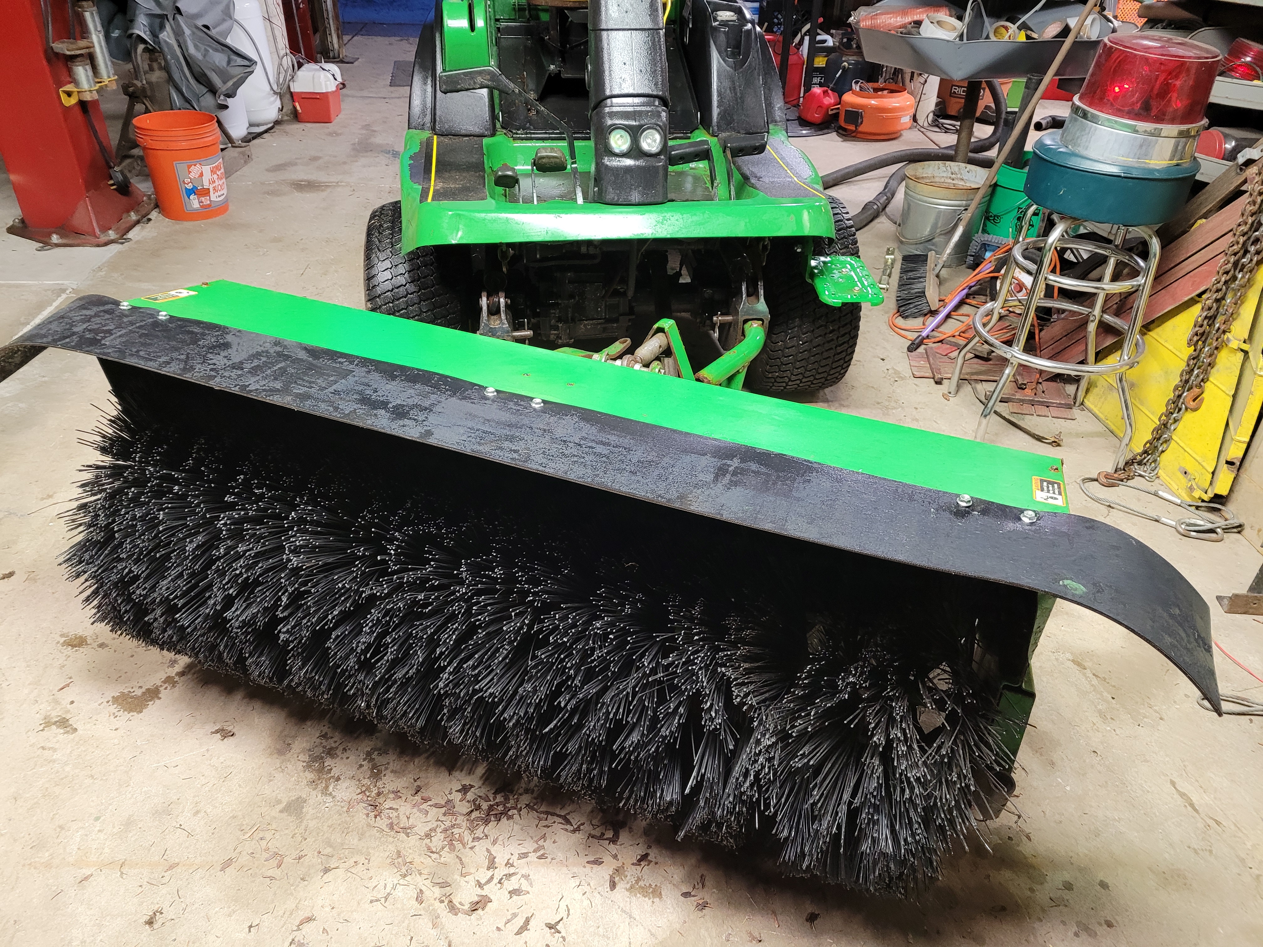

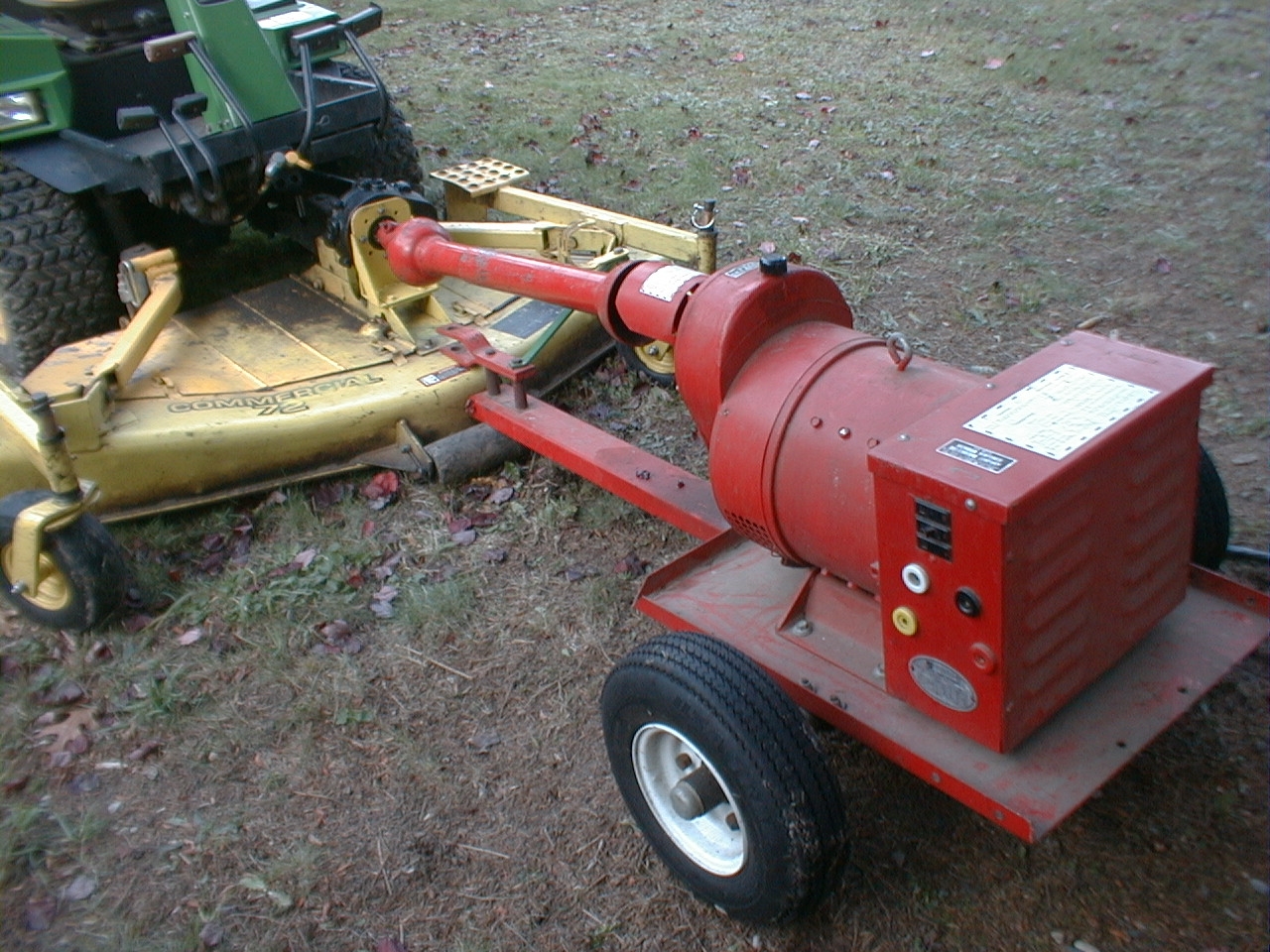

I bought a used JD 1435 diesel front mower side discharge 7-iron at a local Metro Parks auction $2500. Yanmar motor. Starts on the 2 revolution even after sitting for a few months. Found a 60" front rotary broom for it and I will NEVER use or need a snowblower, plow or pusher again, and I've tried all 3 before getting a broom. The driveway is spotless after brooming snow and is dry in 1 hr. I can spray the snow even from 10" drifts as far out as I want or need to using rpm. And it does all this at 15 (measured) mph. The motor isn't even warmed up when I'm done.
As and added bonus, I bought a 3:1 gearbox with a 540 pto stub on it and can run my 45kW Winpower PTO genny off of it. The 1435 is about 22hp so its 11kw potential is plenty of electric power for us. I also still have my F935 earlier version of the 1435. It can also run the genny and a 76" rear discharge deck for chomping thru high field grass, weeds, trees, woodchucks, and whatever it chooses to munch on.
