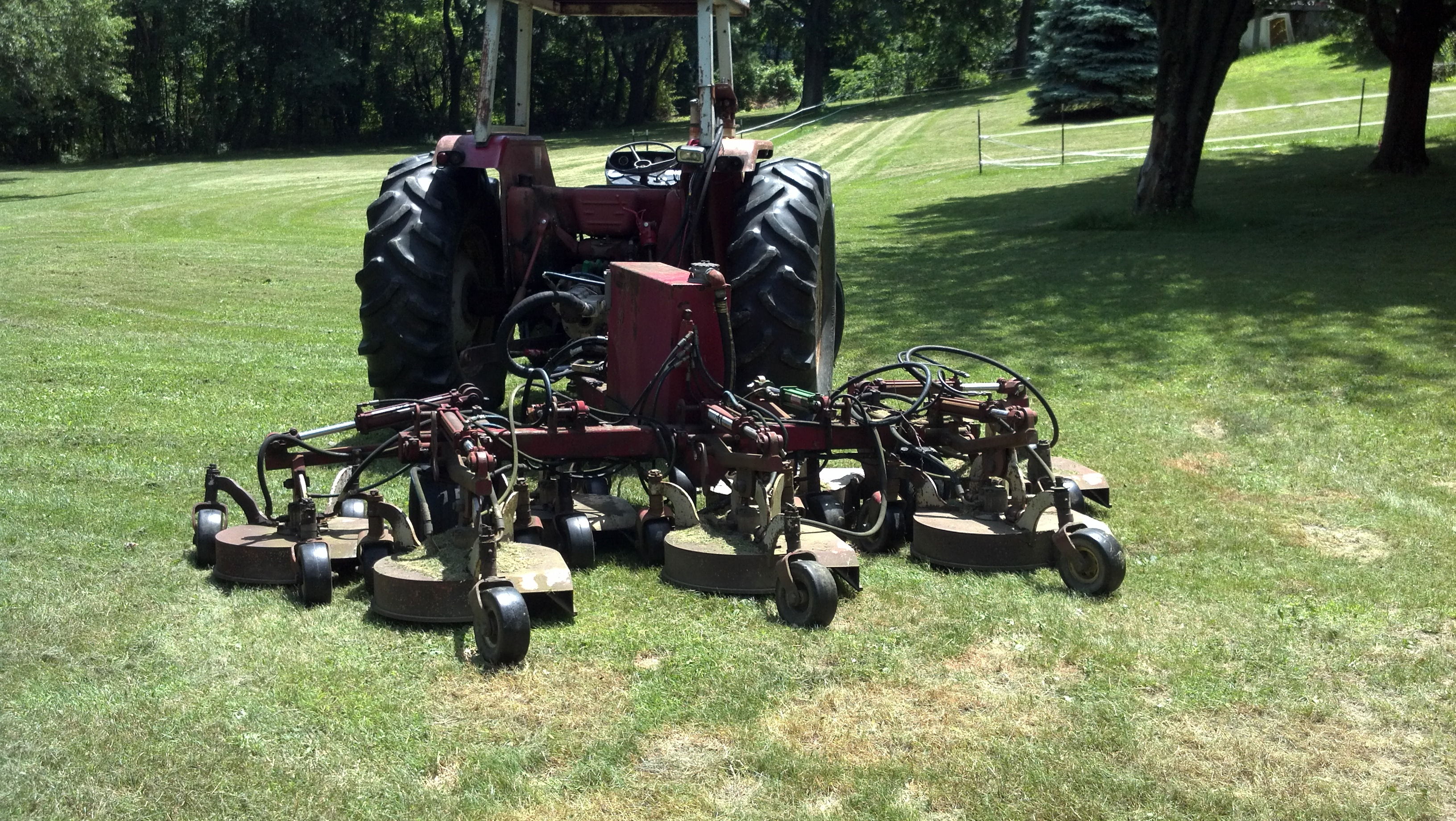

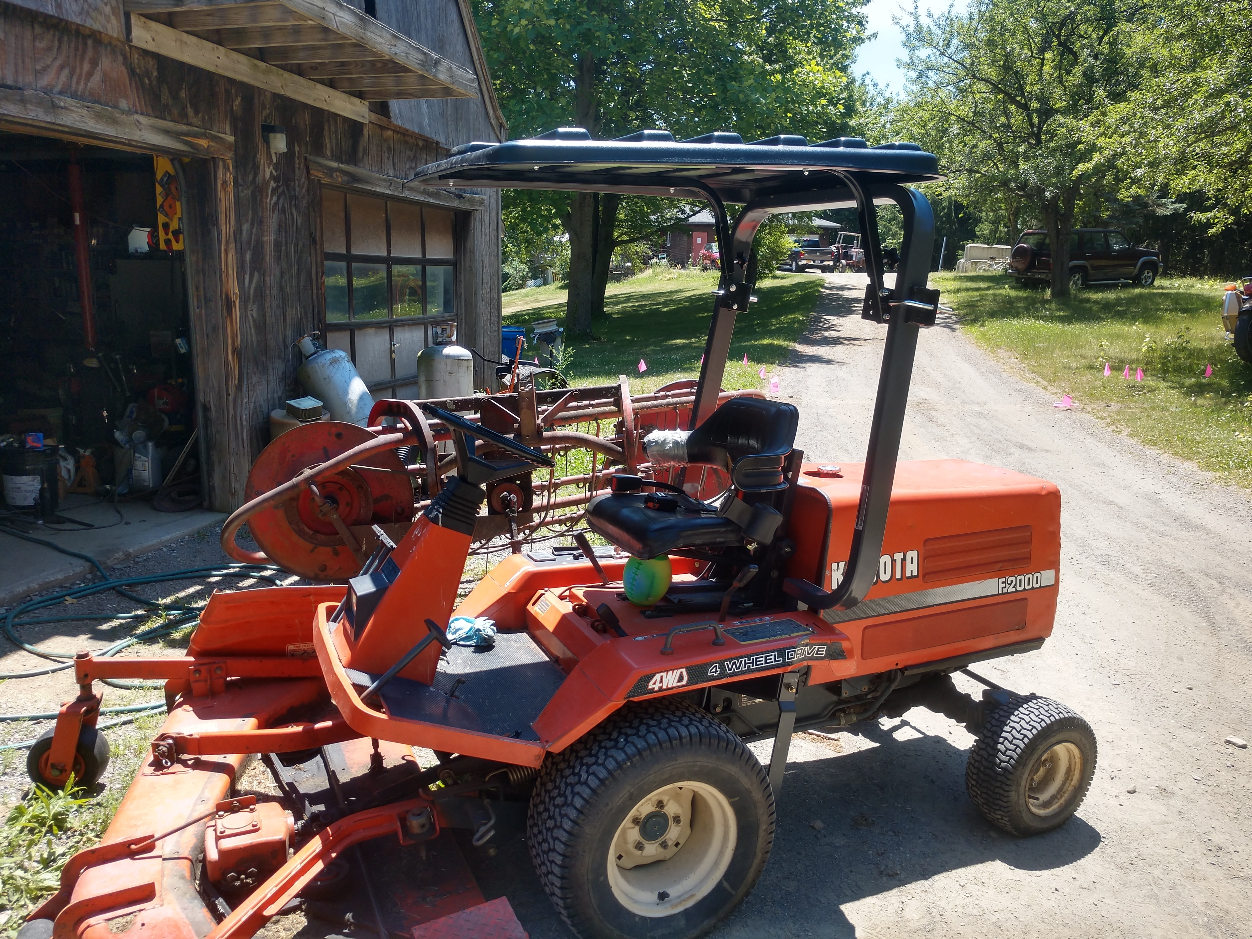

Well I read through this entire thread this morning. A lot of interesting thoughts and ideas.
I used to mow with a 12 foot pull type finish mower. It did a very nice job and got under tree limbs and such fairly well, then I'd trim up with a little JD rider.
Then I picked up an old Kubota F2000 a whopping 19 hp with a 72 inch side discharge deck.
My yard is very rough and lots of trees and hills, I do not mow fast, heck low range and maybe midpoint on the hydro speed. The cut is good and power is not an issue for me. I do shift it into and out of 4wd frequently as I don't care for the turning radius in 4wd and the amount of tire slip. That said turning uphill while circling a large tree I'll often engage the rear axle so as to not spin the main tires as much.
I will often do my trees and shrubs by going back and forth while moving sideways along the edges or around a tree with low branches.
I'm well pleased with the front decked F2000, if it goes out I'll likely look for a similar unit.

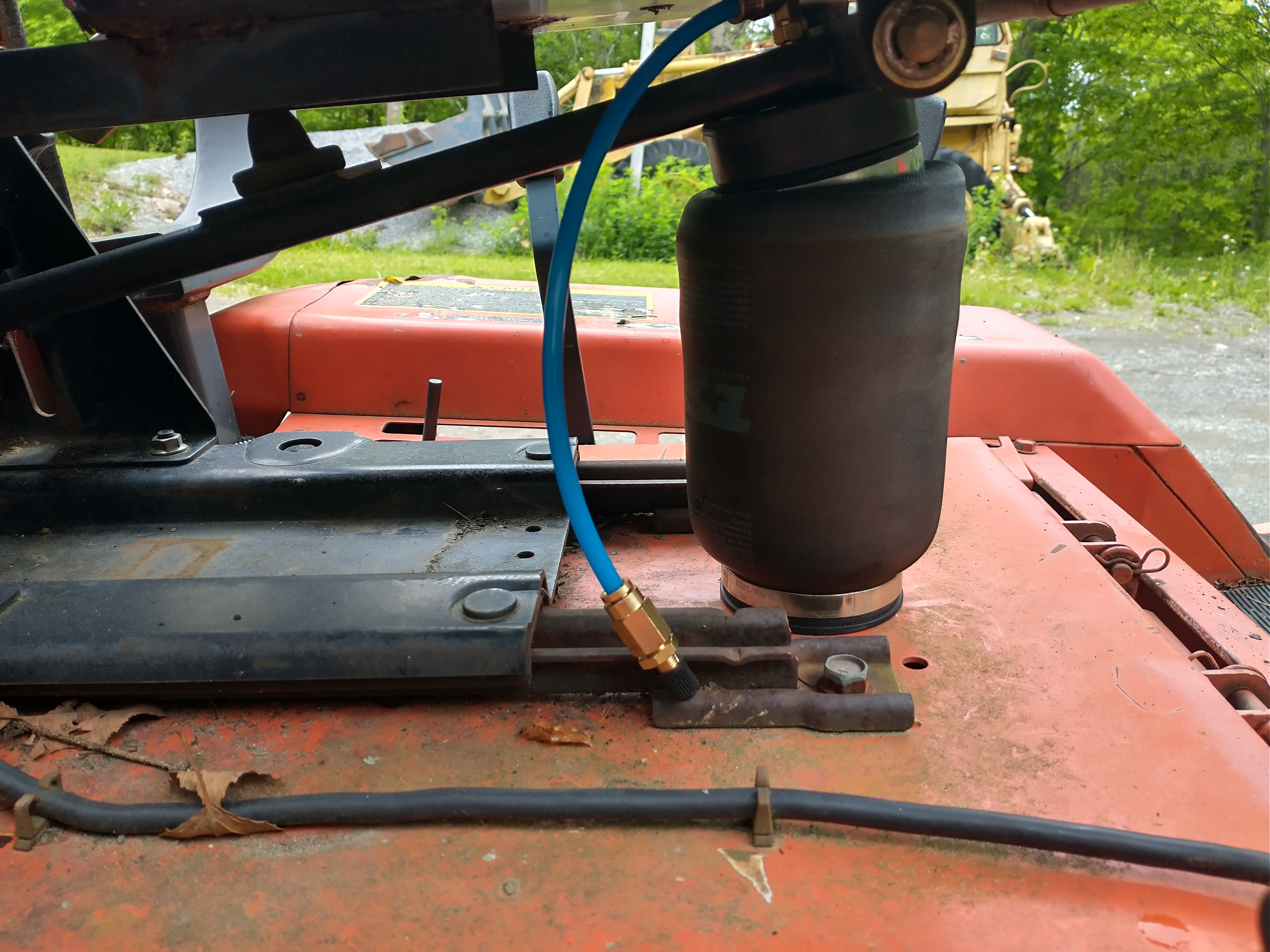

I did add an air spring to the old worn out seat suspension

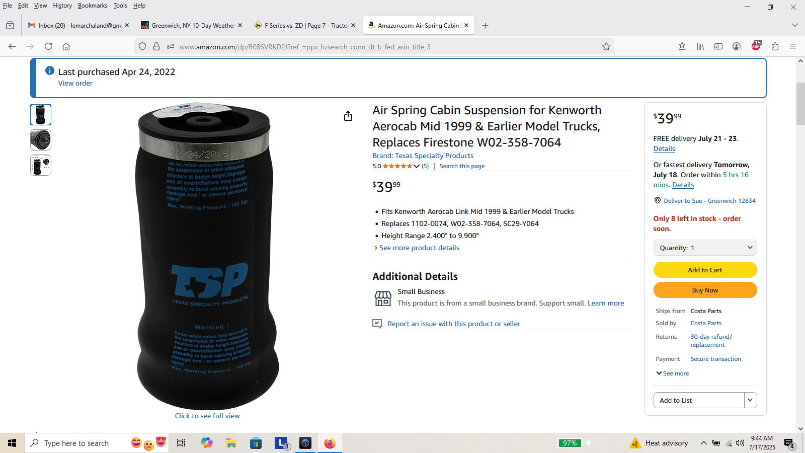

There are numerous air springs around this one is from amazon;
This particular one had the height that I was looking for. Then i just used a right angle fitting in the bag and a schrader valve on a short length of air brake nylon tube. I may add an air ride valve and a small compressor eventually as I do have to air it up a bit every month or so, I'm running about 12 psi in it and it handles my 320 pounds quite well.

SO what holds the air spring in place? Just compresses it enough to stay there or does it move around?

It just sets right in with no clamps or bolting. With even just 2 psi it is a snug fit between the seat and the bottom of the base. And 11-12 psi is were I usually keep it.
