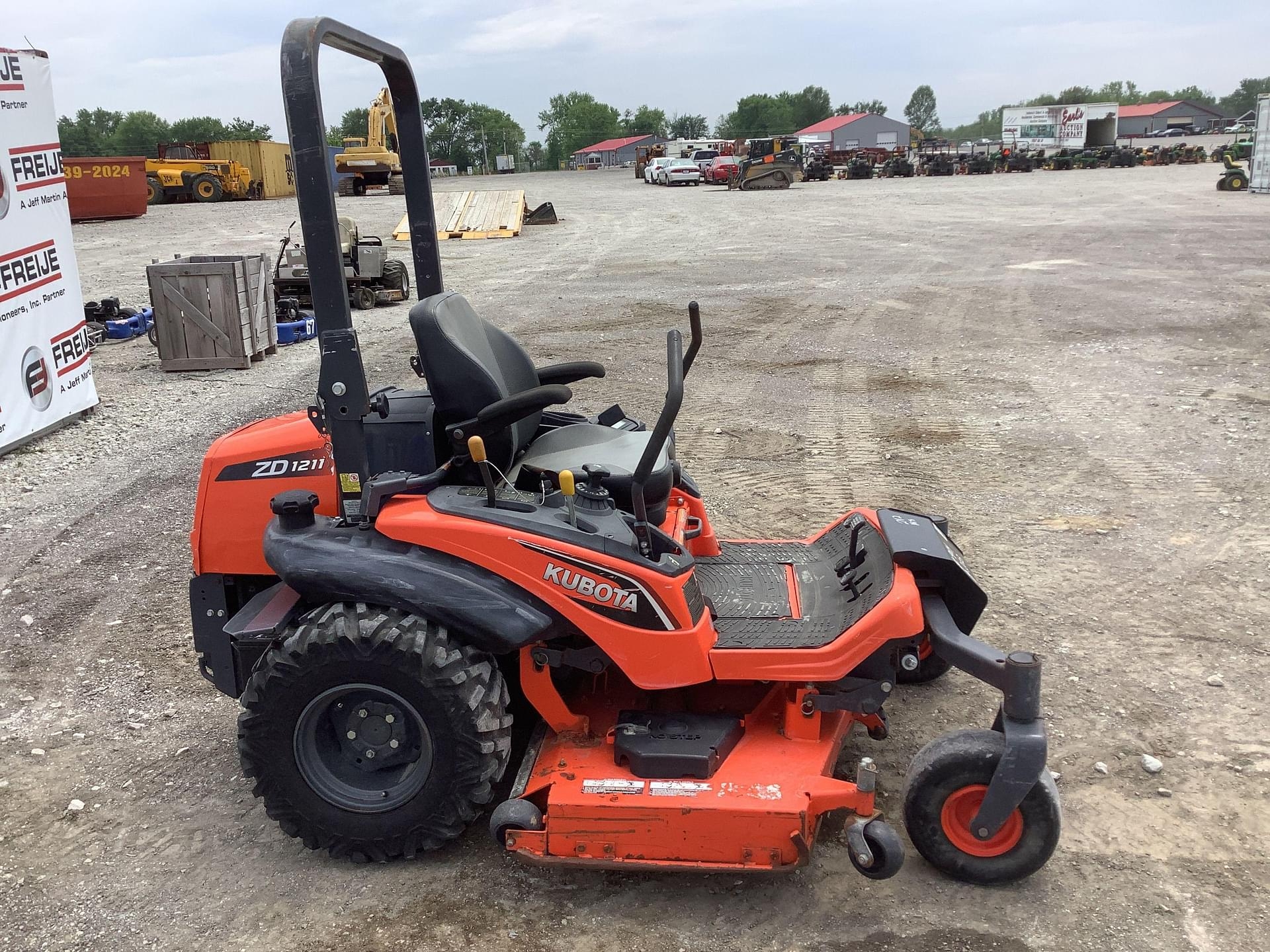

I gaurantee you a ZD-1211-72 rides a lot smoother than a F-3680. I know because I have mowed with both for years over the same lawns. Like I said, the F’s ride is ruined by the small back tires.
It’s not an opinion, but a fact that a 24” diameter tire rides smoother over a bump/hole than a 12” tire.
Another very important consideration that I forgot to mention:
The F mower deck has tiny front tires. This also makes the deck ride rough and if you go fast, it will jump up/down over bumps.
Another very important feature: The F deck requires time and effort to adjust deck height. A ZD zero turn has a hand knob adjustment for deck height. The zero turn mower deck height adjustment is effortless.
The F mower is not easy to do something as minor as a height adjustment on. Removing the deck takes some time and it’s very heavy.

Kubota diesel zero turn is also much cheaper to buy & easier/cheaper to maintain than an F.
You have to remember, the F has a live rear drive axle (it looks like a BX-2200 axle mounted backwards). This axle requires maintenance and has 2 more tires to replace/maintain. The smallish tires wear out fairly fast because they steer, scrub and take a lot of punishment.
To operate the rear axle, there’s an additional driveshaft & U-joints.
There’s also a steering wheel with linkage, compared to a ZD which has levers operating the hydraulics to each wheel.
The F is overall a considerably more complex machine.
New, they are $31,000+
A new ZD-1211-72 is about $21,000
There’s also a 1611 with a bigger motor and more features for about $25,000
