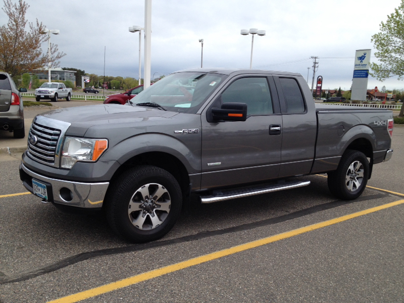

19.6 mpg average is awesome. Mine is a 2012 with 60,000 miles and I'm at 18.3 Chris
Previous owner was a traveling salesman who drove like a grandma and never exceeded 65 mph.
ECSB XLT 4x4 with 3.55 locking rear diff and 36 gallon tank. Truck looked, drove and smelled new. They were asking $16,700. I almost jumped on it, but was leery of the miles etc.
