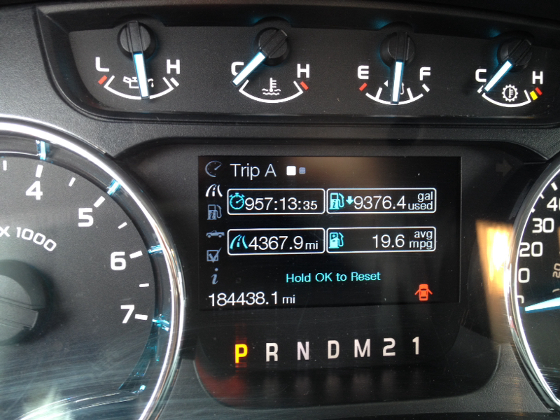

I test drove a 2012 with 184k and noticed no shuddering. Didn't check to see if intercooler was drilled, but I doubt it, because it was only serviced by the dealer.

19.6 mpg average is awesome. Mine is a 2012 with 60,000 miles and I'm at 18.3
