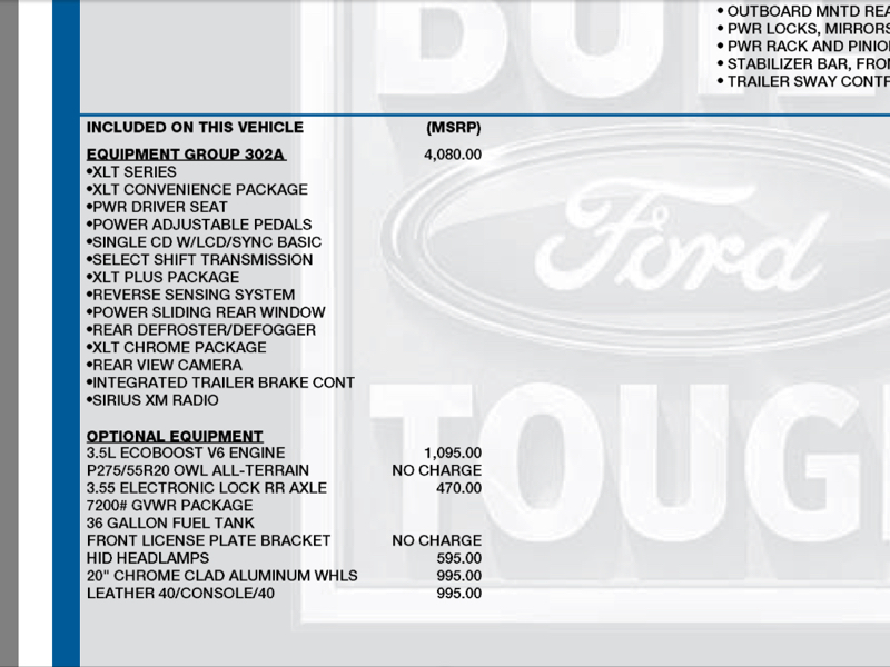

I have kept holding out, but feel now may be best time to make s change. The guy that has the 2011 has postponed moving to the 2015 until prices come down and I have found that they are running around $9500 off on 2014 XLT's with the 302A packages. Was looking for a Ecoboost, 4wd, Supercrew with Max Tow and 3.73 axle ratio. These are proving to be hard to find. I had convinced myself to move to the cloth seats from the current leather. Was wanting 40/20/40 seats versus buckets like have now. Rest of the family strongly encouraging to stay with leather. Found this truck on local lot with XLT, leather and few upgrades like HID lights and 20" wheels, all that I like. Been reading and talking more on the Ecoboost too about the moisture/condensation/misfire issue. Seems to be a fairly common issue. Overall seems a 50/50 split on Ecoboost versus 5.0 preferred. I will trailer my 5303, 4wd, with FEL with either 8' 3pt disc or MX6 cutter on a 22' bumper pull 3-4 times a year for approximately 30 miles round trip.
Looks like with a trade in I can get in a brand new truck for what I got in my current truck used with 45,000 miles almost 8 years ago with same features. Any reason to be concerned with the 3.55 axle or Ecoboost? Will be daily driver approximately 300 miles per week. All opinions and feedback appreciated!

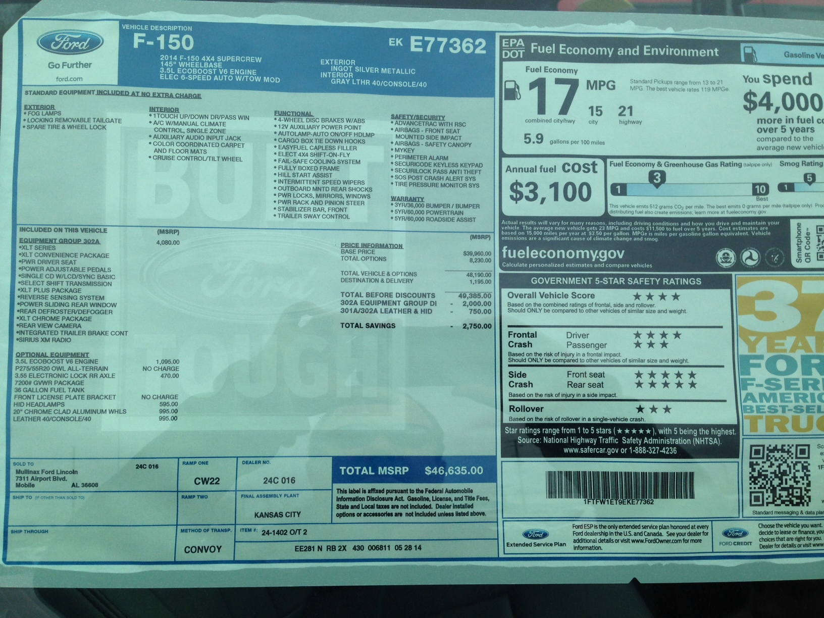

Interesting. Here is a sticker on one that was found in another state that is reportedly no longer available. Notice I believe it states GVWR is 7650.
That one has LT tires on it too. Probably has max payload option.

We haven't gotten to a bottom dollar price, but one salesman told me they were going $9500 off the sticker. This is the sticker on the one with pictures I attached earlier. You mean all F150 drivers don't tip the scales at 150 lbs???:laughing:

Here is one found this morning. I don't see any mention of what tires/wheels are on it. What does your 2011 have?
