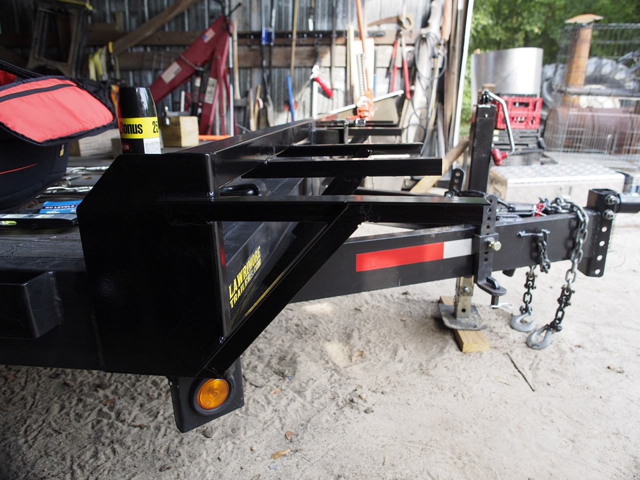

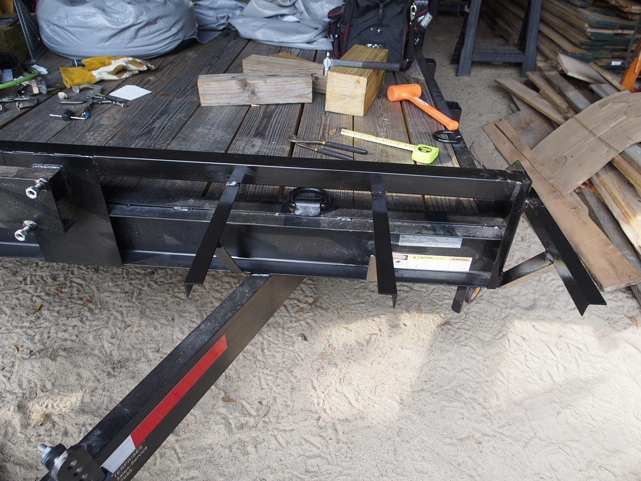

Curious how you have your boxes mounted on trailer. Wanted to add a tool box, but couldn't come up with a good way to do it. I have wooden rails built that I use annually for hay rides. The front crosses behind the tire and flush with front rail.
It took me awhile to come up with a simple, yet strong way of doing so. I basically fabricated 3 "L" shaped brackets (like standard shelf brackets) out of 1.25", 1/8" angle to support each box and then a down piece at ~ 45 degrees to tie it all together. I actually only created the top horizontal piece and the 45 degree angle down piece with the existing trailer being used to act as the third, vertical triangulation point.
Each piece welded individually to the trailer instead of making each "bracket" separately and then welding to the trailer. Each box is bolted to its outboard and inboard brackets with two ~ 5/16" bolts with a Stanley 1/4" x 1.25" x 12" plate (HD, Lowes, TSC) sandwiched inside the box between the nuts/washers and the bottom of the aluminum boxes for attaching strength and rigidity. Then thread locker on the nuts. Ended up being pretty simple and strong once I figured out the design. Mounted, each of the boxes inner ends sit flush with that inboard bracket and the outside box end sits ~ 4" past the outer bracket (unsupported) since the boxes are wider than the trailer- as mounted due to the spare tire taking up so much center space.
The top horizontal pieces attached under the trailer's top square tubing, extending the whole 3.5" to the back edge of that tube- which is pretty thin walled tubing (burnt a few holes I had to carefully weld and grind). And the downward, 45 degree pieces rest with the bottom edge of the trailer's C-cross brace and kind of jammed into that edge before welding. Really hard to explain but that piece is self supporting at the bottom joint with the welded joint not providing any real strength and really just holds that brace in place against the C-channel edge and keeps the angle from twisting away from its supporting point at the C-channel.
If I had things to do over again, I may have gone to a 3/16" thick down piece instead of the 1/8" as this piece is where the majority of the strength is. But it is probably not necessary and I am prone to overkill in most things I do.
