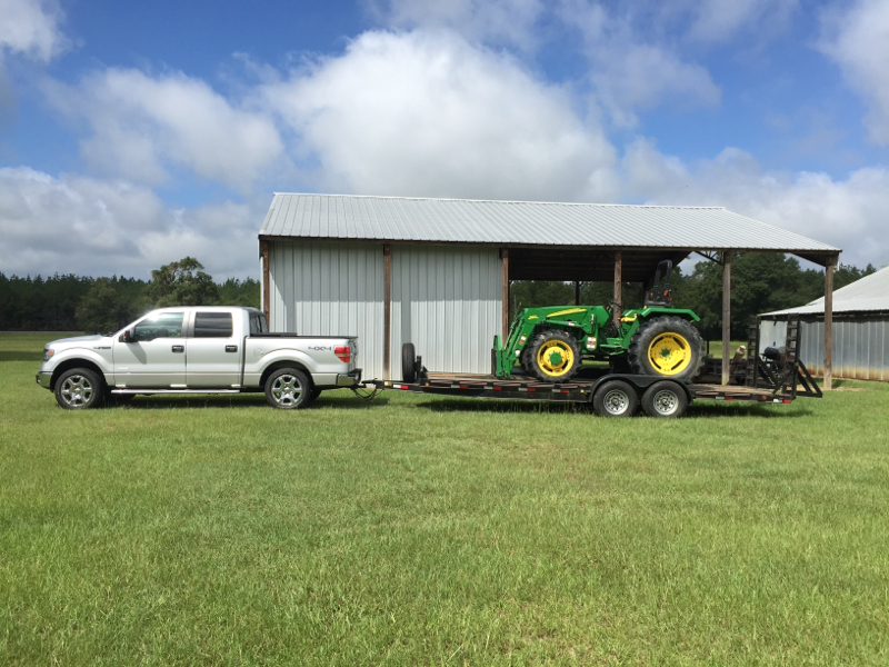

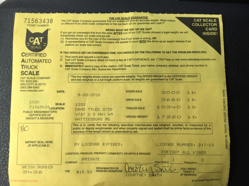

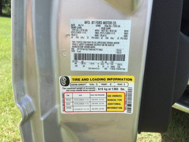

Made it by the scales today with the following: 2014 F150 Crew Cab 4WD, 145" wheelbase, 20" wheels, driver only, 1/2 tank fuel(18 gallons), 22' 12k lbs rated bumper pull trailer, 2008 JD 5303 4WD, loader and forks, full tank fuel and rear 16.9-28 tires filled with water.

Nice! so how did it pull the load? You should have a weight distribution hitch for a load that heavy.

nice that you can pull that load and still not be overweight on any axle!

Probably right on the WD hitch. Have considered purchasing one, but usually forget due to rare occasions for pulling tractor.
As for towing performance, I am very impressed with the 3.5 Ecoboost and the integrated brake controller. When approaching hills transmission simply downshifts without any major notice and maintains speed. When stopping, brakes on trailer increase resistance just like truck brakes as pedal pressure increases. Overall truck seems to handle this weight effortlessly.
Agreed. Usually would have MX6 cutter or 8' disc harrow on and tractor further forward. I suspect that greatly increases the rear axle weight. May swing by scales again next time have a different set up on to compare.

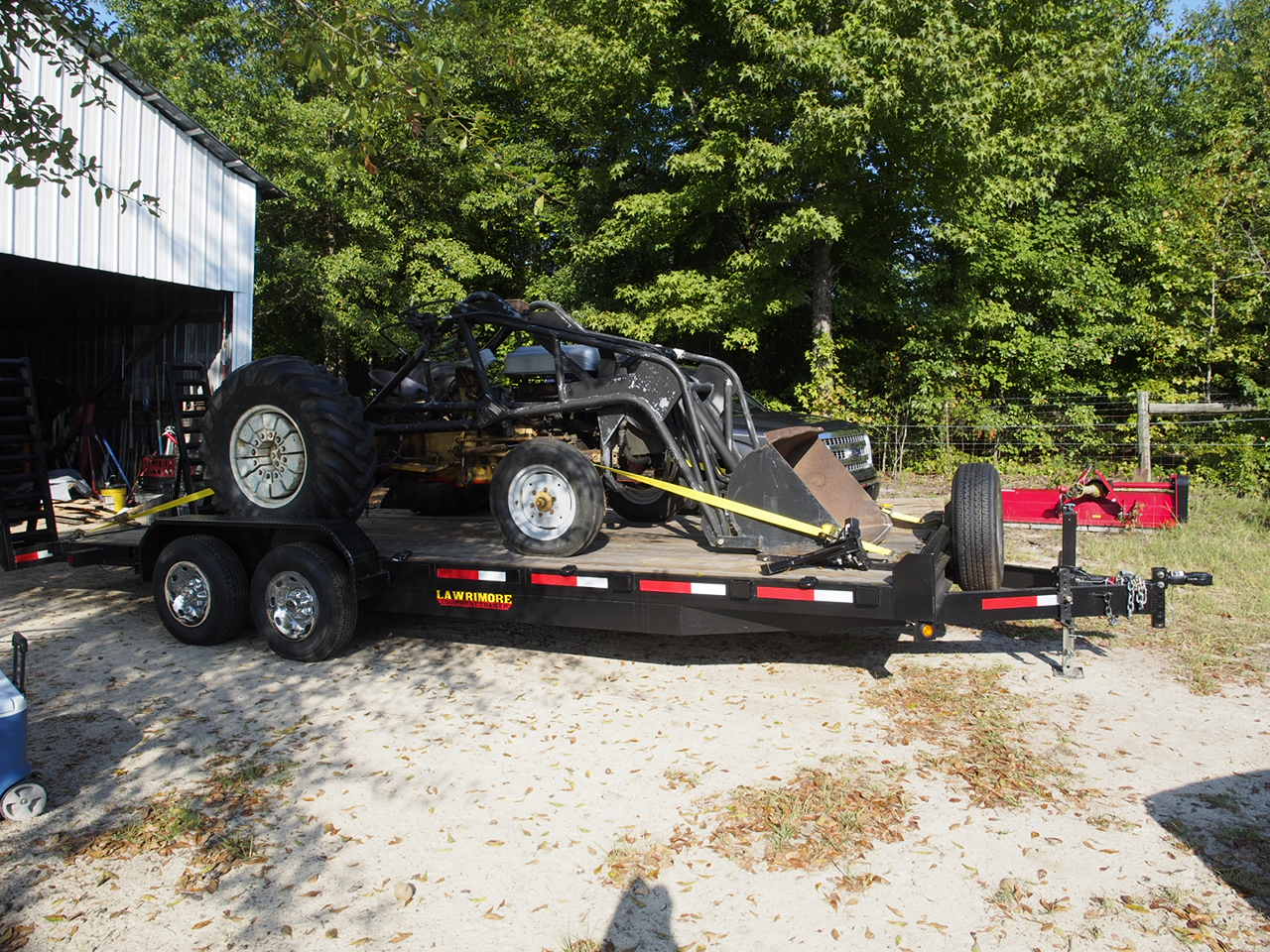

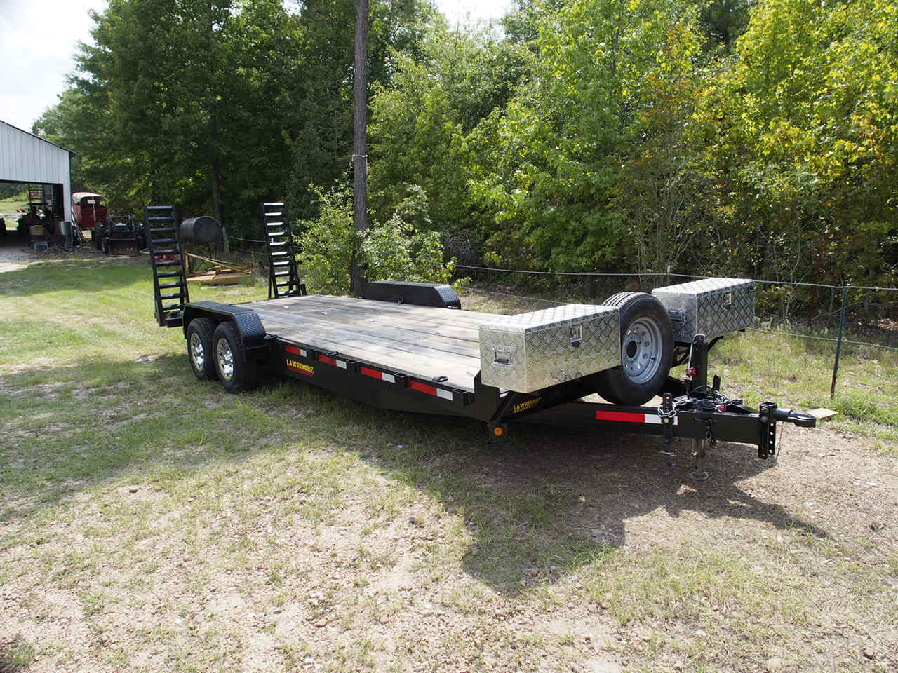

Yep. I have a new Ram 2500 diesel, 4x4, crew cab Ram Horn and did a lot of setup and testing with a 10.4k 20' equipment trailer and an old Ford tractor. With 1150 pounds on the ball (~13% TW), measured by a Sherline tongue scale (Sherline Trailer Tongue Weight Scale - 2,000-lb Capacity Sherline Tools 5780) and a Weigh Safe load bearing ball mount (Weigh Safe 2-Ball Mount w/ Built-In Scale - 2-1/2" Hitch - 10" Drop, 11" Rise - 12.5K Weigh Safe Ball Mounts WS10-25), the handling was much better with the old Equalizer 10k unit than the weight bearing assembly. Had I been using a higher rated WD model (spring bars), I am certain it would have been even better. A Blue Ox BXW1500 is on my wish list._EM50521.JPG_EM50504.JPG
