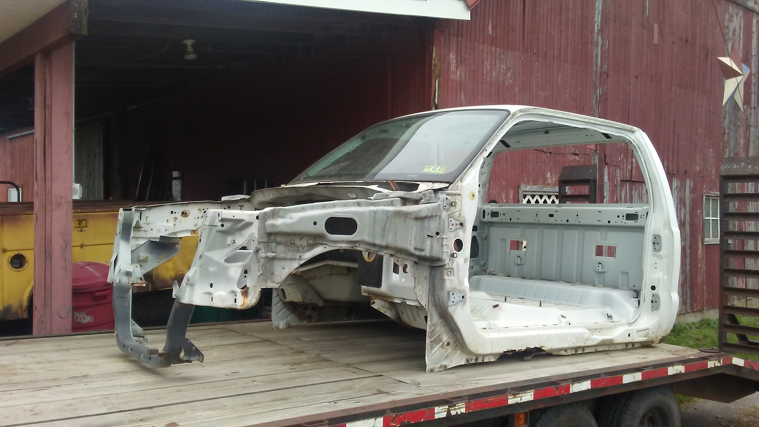

Fingers crossed, but it looks like there's a real good chance I'll be bringing home a stripped cab for an F250 extended cab tomorrow. Dirt cheap, so im not gonna think twice about cutting it up. Stay tuned... about time to start a new thread, the super-seater truck thread... *grin*
   / F250 motor swap, 7.3 diesel
#250
Much to disappoint of my wife, more junk came home with us today! 2001 F250 extended cab with manual trans tunnel... Well worth the $100 for the good windshield alone!
