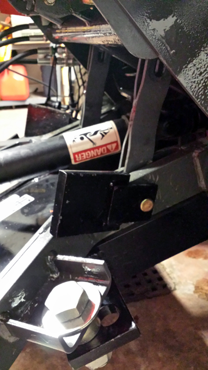

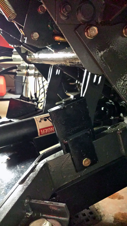

Dan,
Yet another question about lift stop kit.
Looking at the manual, the drawing has the piece sitting upright, resting on the lift arm. On mine, they lay on their side. Is this correct?
In one photo I show how they were positioned when delivered and the second photo is after I lifted it into an upright position.
Lyle

Now this is not right Lyle,
The tang with the hole for the 1/2" pins should fit into the the slot provided in the lift arms, that way the travel stops can't rotate, the service folks put them in wrong. I'll head into the shop and snap a picture for you.
Dan

I took some pictures for you, see what I mean...
Dan

Thanks again Dan. I'll go correct their mistake. Good dealer but I suspect they haven't installed one of these blowers in a while.
Lyle
