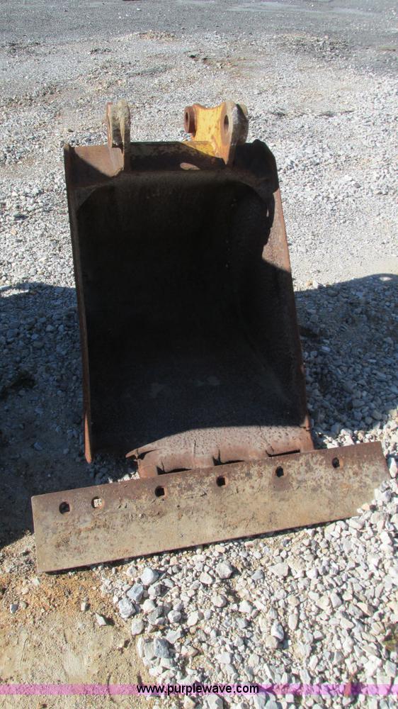

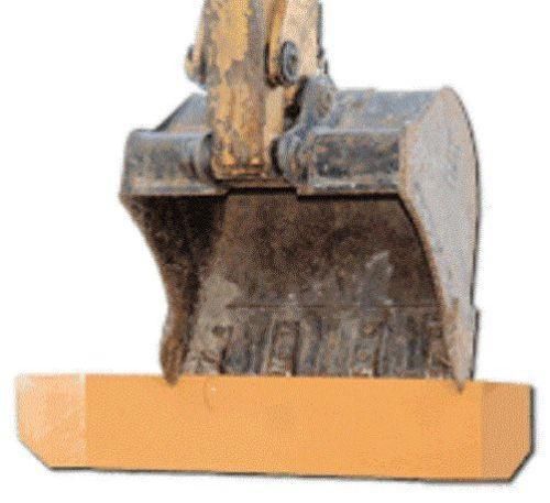

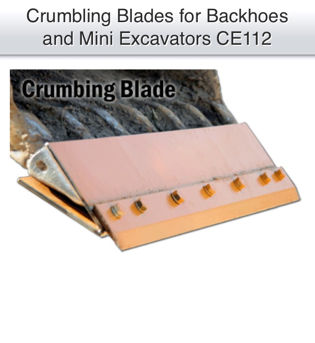

I am hoping to fabricate a plate to bolt onto my mini-excavator bucket to create a grading or ditching bucket. I have some scrap steel and am trying to figure out an easy way to bolt it on to basically cover the teeth and give me a smooth cutting edge. Here's a couple poor photos of what I found while searching.
Anyone with experience with this and have some photos or ideas to share?
Thanks in advance.

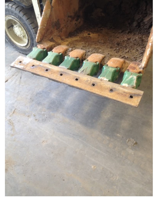

A pic of one.

I had a JD #7 backhoe. After several attemps to come up with a bolt on plate that would be strong I finally just took a 6 X 14 X 1/2 plate and welded it to the teeth. Worked great.
