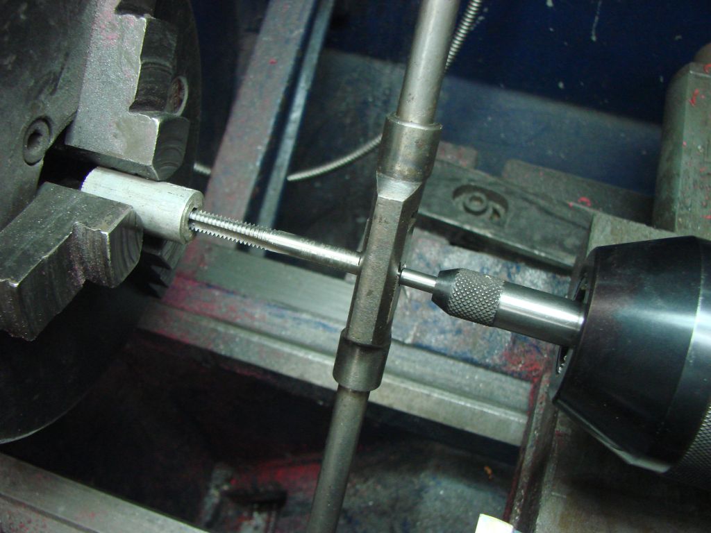

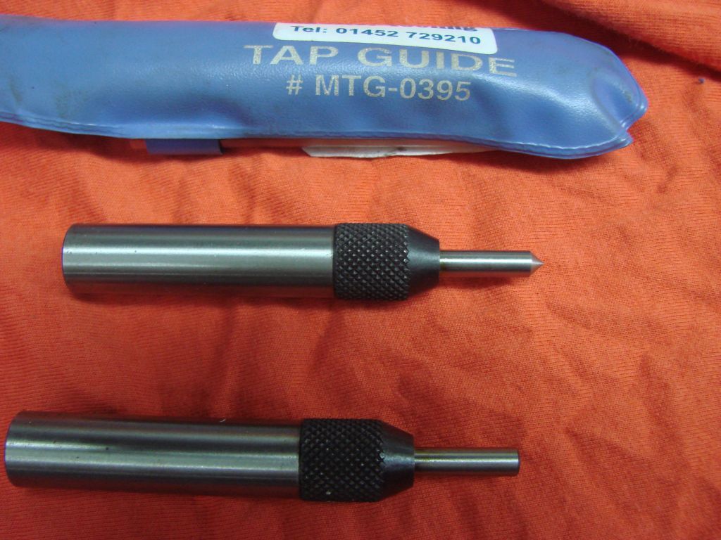

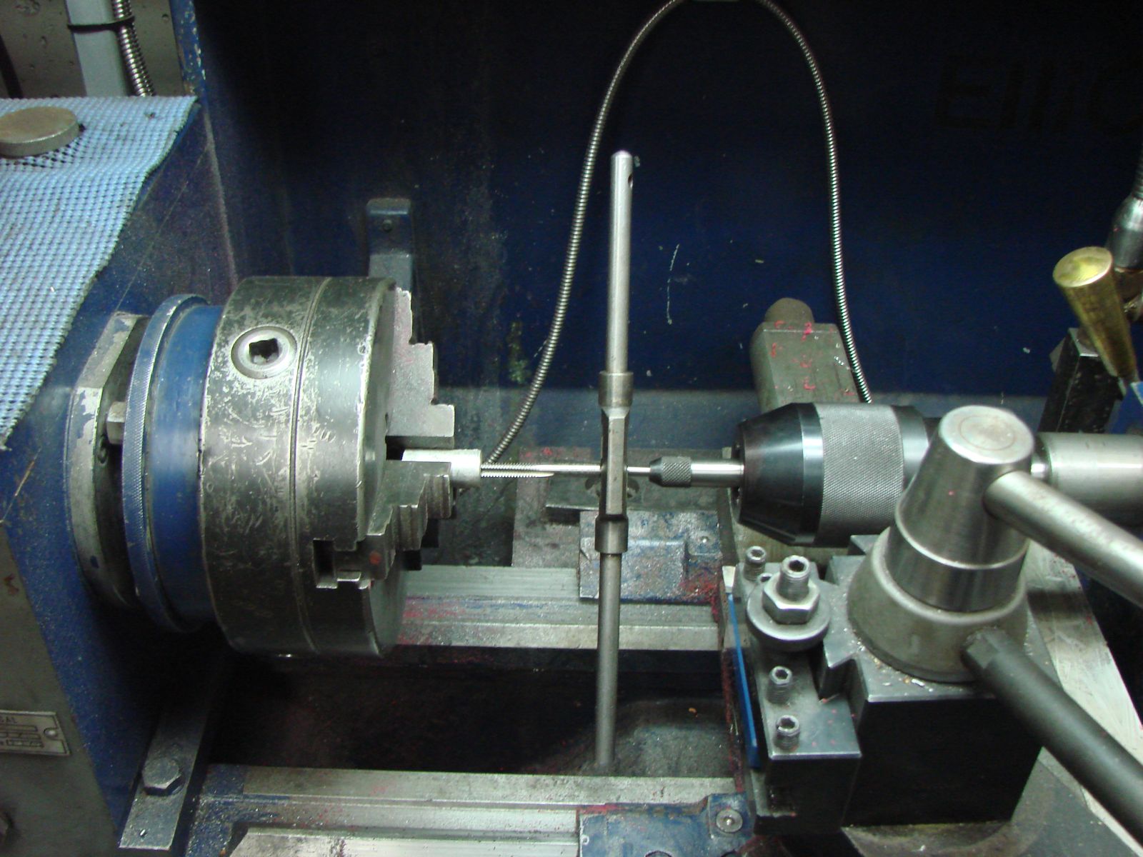

Seeing we're on the topic of tapping now I figured I'd show you something I use a good bit and find it great and it's called a tapping guide.
I use them in the mill and lathe. They are spring loaded and if you were tapping in the lathe you would chuck this in the tail stock and put it up against the tap and where it's spring loaded it keeps a constant pressure on the tap and you don't have to keep moving the tail stock.
There are a couple of different ends on a tap and as you can see the two types in the photo.
I got two of them but you would only need one because you can take the Alan nut out on the end and flip the double sided shank over and use the end you need. I got two of them so I don't have to do the flip.
   / Fabricated rear PTO guard #44
Paul- would you be so kind as to post a photo or two of your tap guide in use- in other words, the tap in use on your lathe? I am guessing the work piece is turning, the tap is stationary, and the tap guide is pressing to advance it? How's that work??
#45
You got it right. All the tapping guide does is keep a constant pressure on the tap while you manually turn the tap. If you never had this tool and you had the tap in the tail stock of the lathe you would not only have to turn the tap but also have to keep moving the tail stock to keep pressure on the tap. Thanks to the spring in the tapping guide this is done for you with the tapping guide. I'll post a few photos for you in the morning.

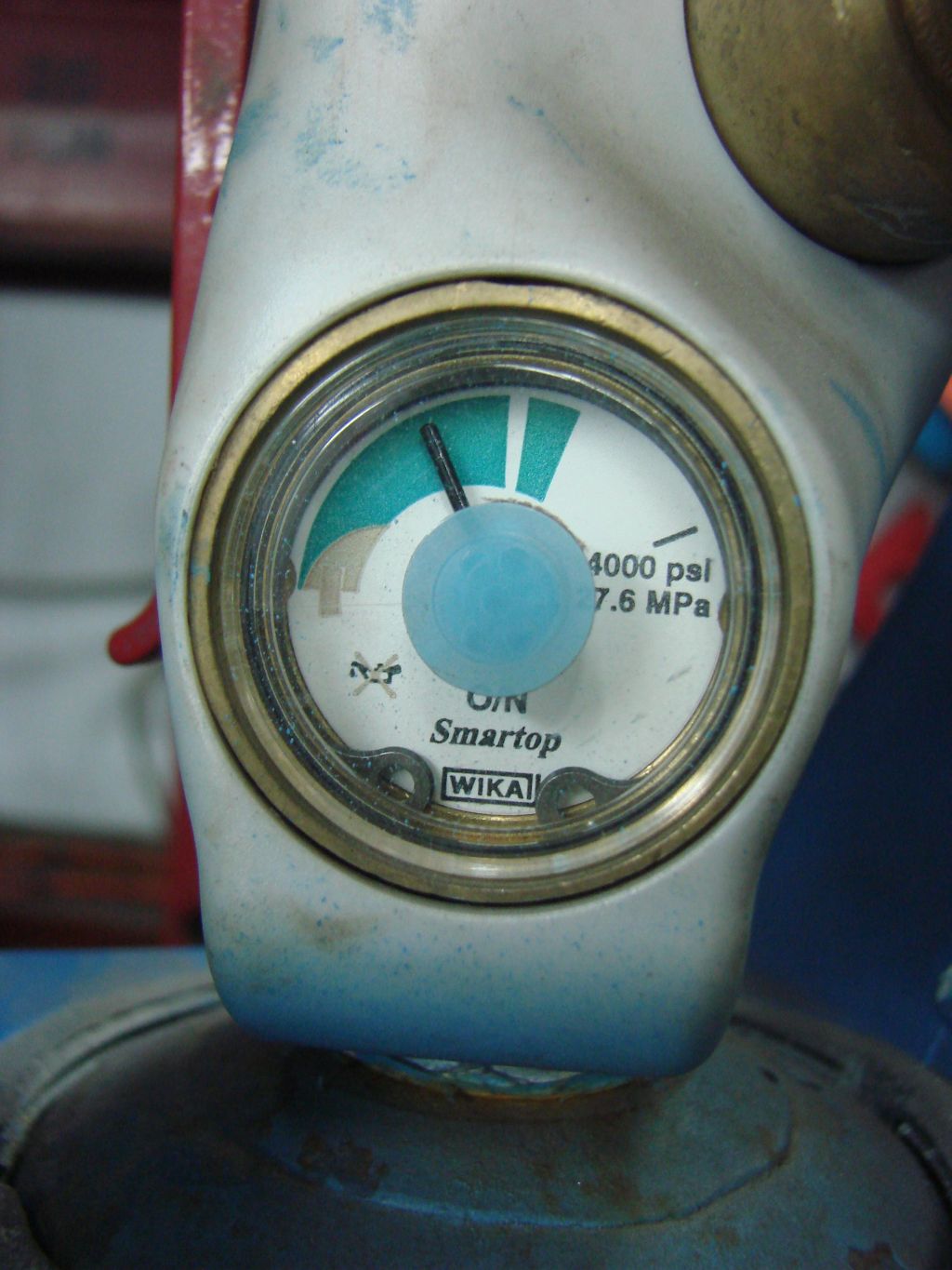

Here you go buddy. I also scanned the packaging for you and got a close up of that tank you mentioned.

Thanks, Paul. I should have realized how you use the tap aid. I used to use lathes a bit, back in the 60's mostly, when my dad ran an aircraft maintenaince facility that had a nicely equipped, although WWII era, machine shop. Got to go in on evenings and weekends and play with stuff. Had some fun with making stuff out of aluminum sheet, also.
I'd like to have a lathe, but don't really need one, and various tooling bits and pieces would bankrupt me. Oh, and a milling machine, while I'm at it.
