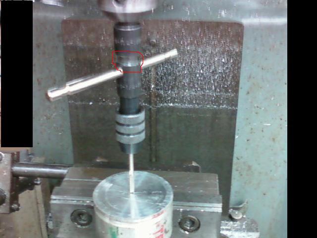

I could see it for larger taps, but on the 0 - 1/4" sizes that I normally use I'd be worried about snapping the tap.

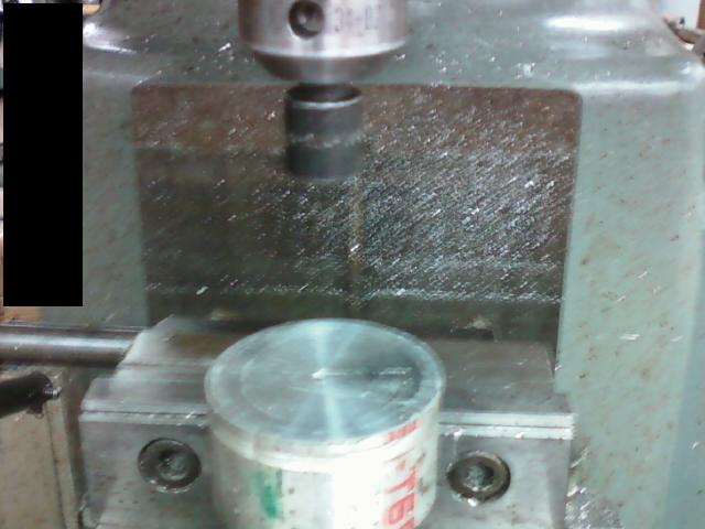

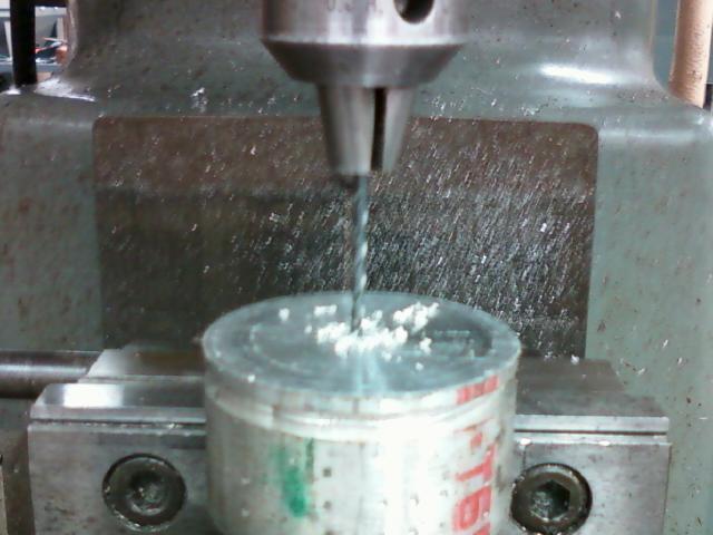

Nope, it's used in a "power off" mode. You use the quill to hold the top which spins on the t-handle. For illustartion, this is a #36 drill and 6/32 tap

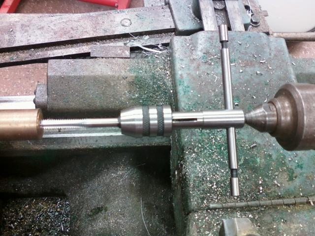

Or if you prefer a more traditional approach, a 1/4-20 tap handle using a live center for alignment
