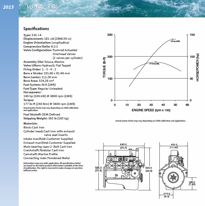

Something else to consider... if you have a PT425 and intend to drop in a 22hp engine, you may notice a difference if you intend to power a 60" mower. When I was considering a PT back in 2001, Terry at Power Trac highly recommended NOT using a 60" mower on the 22hp unit. He said 48" would be the max. He also said you'd notice a considerable difference with broom, tiller, brush cutter, etc.... between the 22 and 25 hp units.
I'd like to see the torque curves on that diesel and the robbin and kohler 25hp motors.
