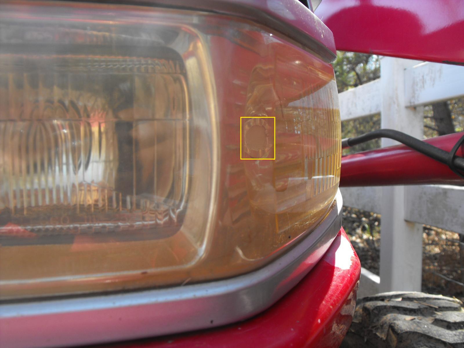

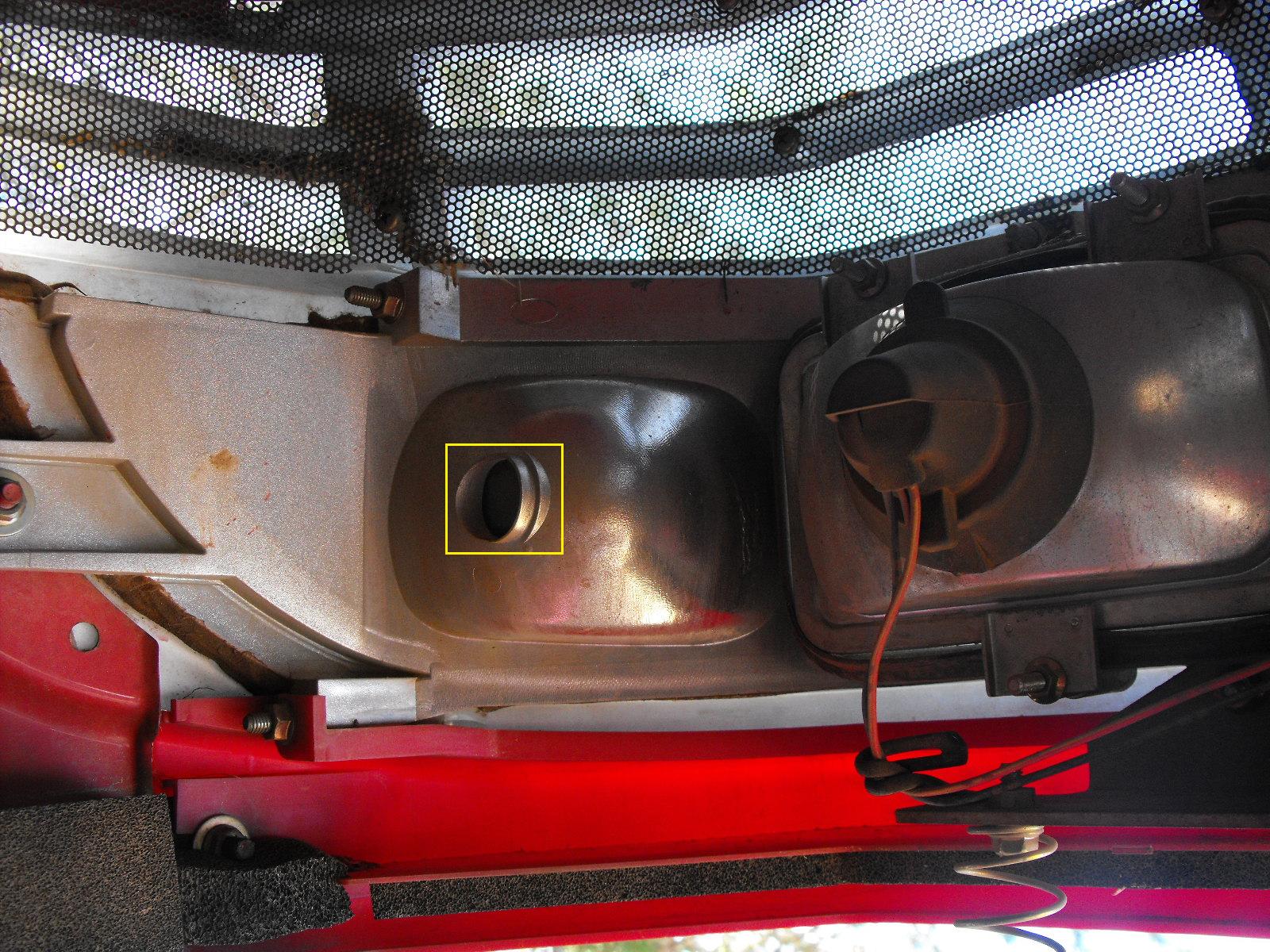

Well the manual says that it is for a 2815HST, 3215, 3215HST and as far as dimming the lights, I'm guessing that they are talking about high beam and low beam that we don't have.:( Have you noticed that there are blank spots on the reflector housing for additional lights that they do not use? Maybe a place for turn signals, but are not used?
Yes, I call them side lights or markers. Took some pics today from inside and outside the hood. If you can find the right size bulb sockets looks like you could twist them right in.

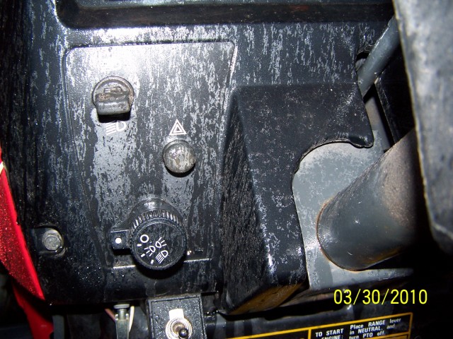

George, could you get a picture of your headlight switch and post it. I wonder if your type of switch is interchangeable with what I have. I really would like to have a 3 position switch, but want it still to look original.

Attached is my headlight switch pic. 3 positon Off- Park- Lights. above it is a push button switch for flashers and a toggle for high/low beam. (As you can see the tractor is outside and its raining). Lever with white dot is for turn signals. Looks totally different from yours.

George, thanks for the picture, although the switch does look different, it would still look OEM and I think that it would be a better set up. The way mine is now, I sometimes bump the switch with my knee and turn the turn signal on. Without going back outside, how far do you think that the switch actually sticks out from the dash?

Switch sticks out about 3/4"-1". I have also unknowingly hit the turn signal lever with my knee. Not so much a problem for guys with shorter legs. I mentioned to a friend of mine that he wouldn't have that problem since he has shorter legs. He said," what do you mean short legs, they reach the ground don't they."
