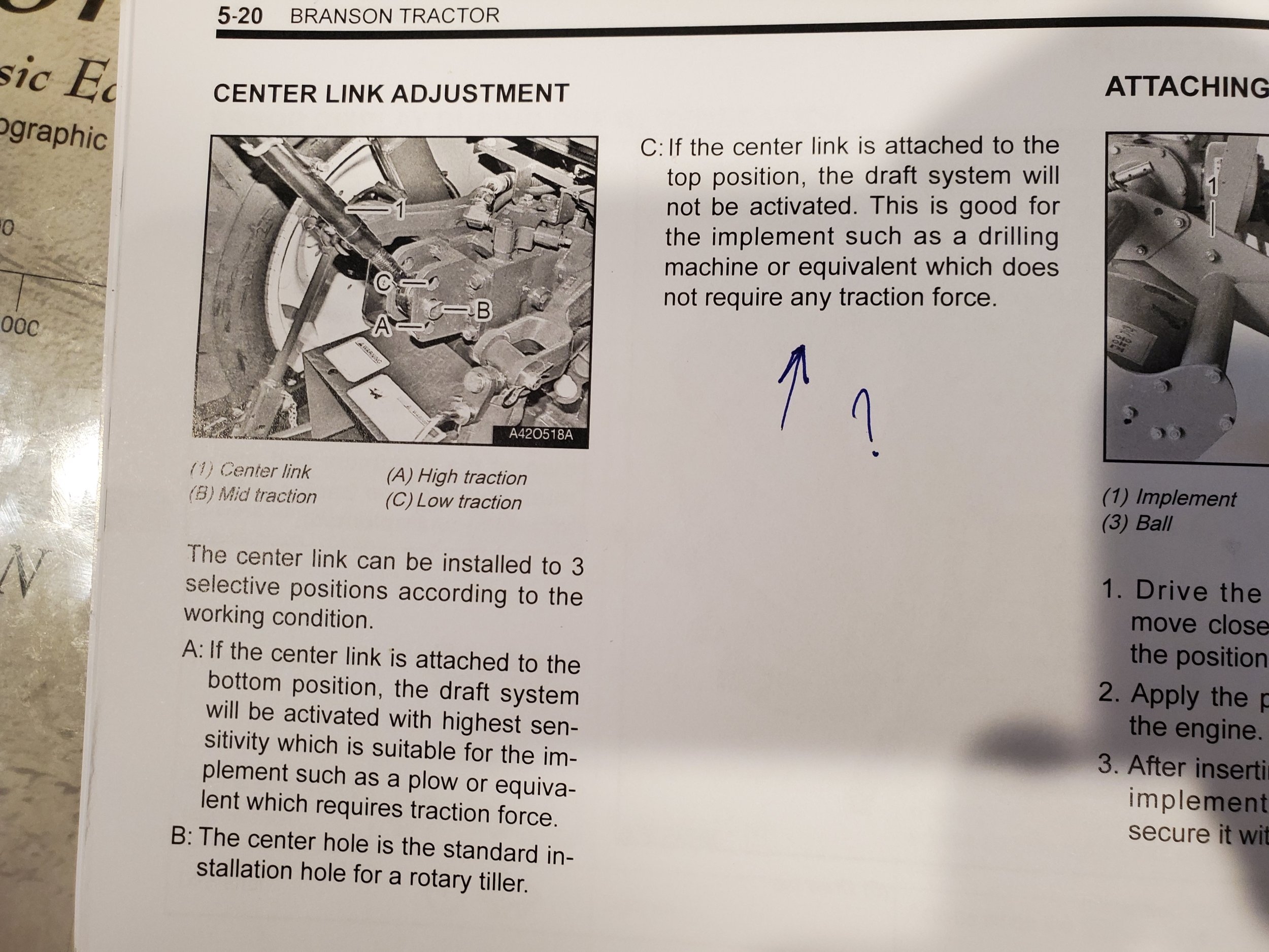

I did a lot of searching on that when I got the tractor several years ago, it seemed the upper hole was more common, and nothing in any of my manuals talks about it. What determines which hole to use...
My Kubota manual, IIRC, is also vague on those holes. Reminds me of textbooks that flog the intuitive points and just dutifully mention the less obvious stuff.
   / Failure, how did this happen? #13
I'll concede that, mine only has upper and lower though, no middle option unfortunately.
What is the deciding factor on which is the best to use for a specific implement?

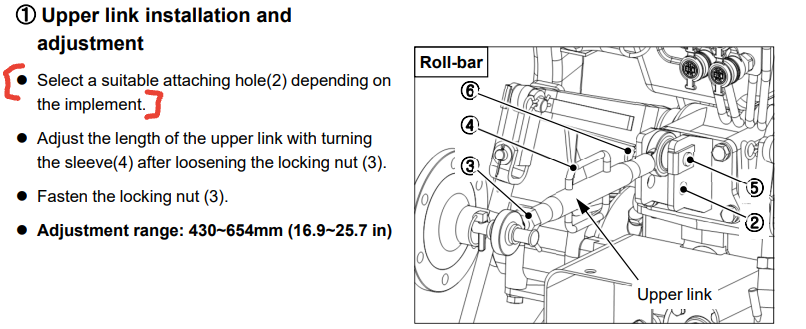

Here is what my manual says. It is three hole but you probable can get the idea.
Also, i vaguely remember there was an extended discussion on this forum abut this topic.
EDIT: I found some discussion. It is not what i remember reading but there is some helpful info as well

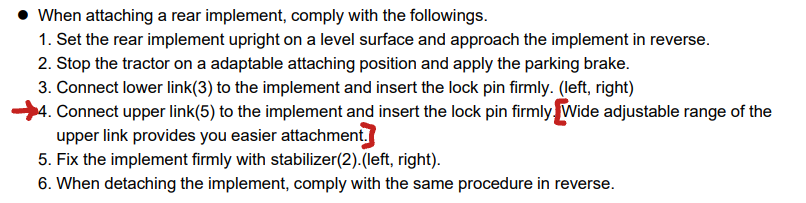

here's mine, useless lol
The image above does not use the numbers in the image below.
