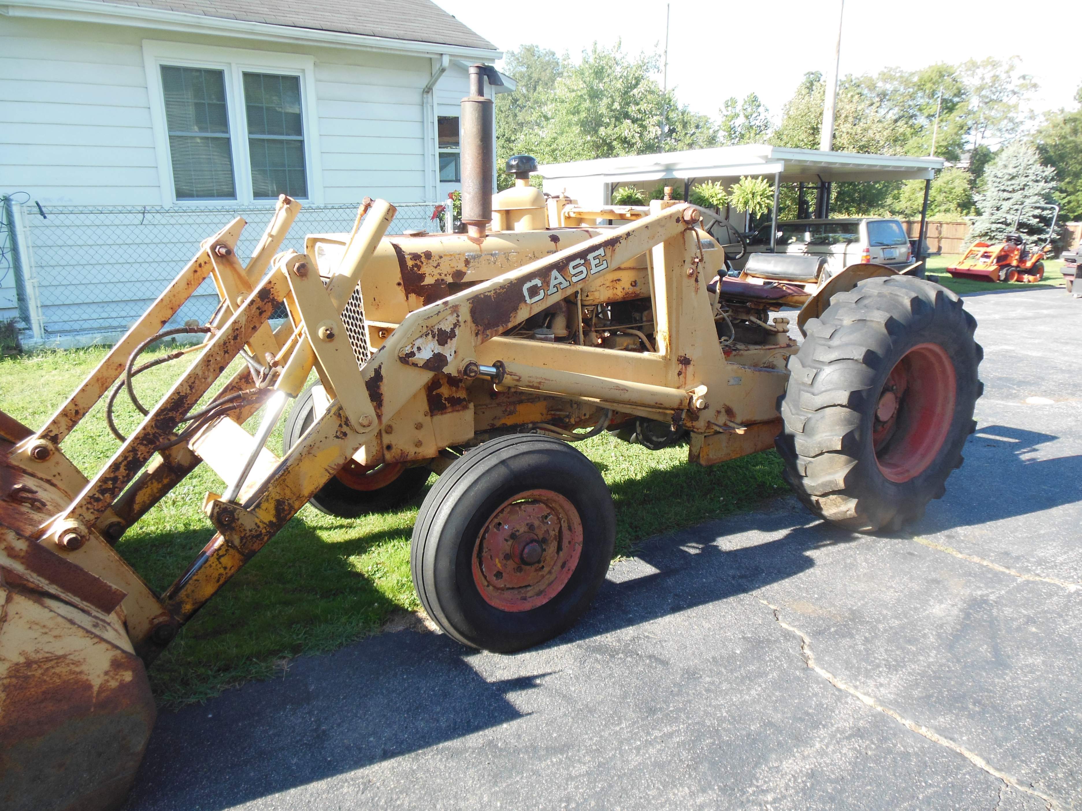

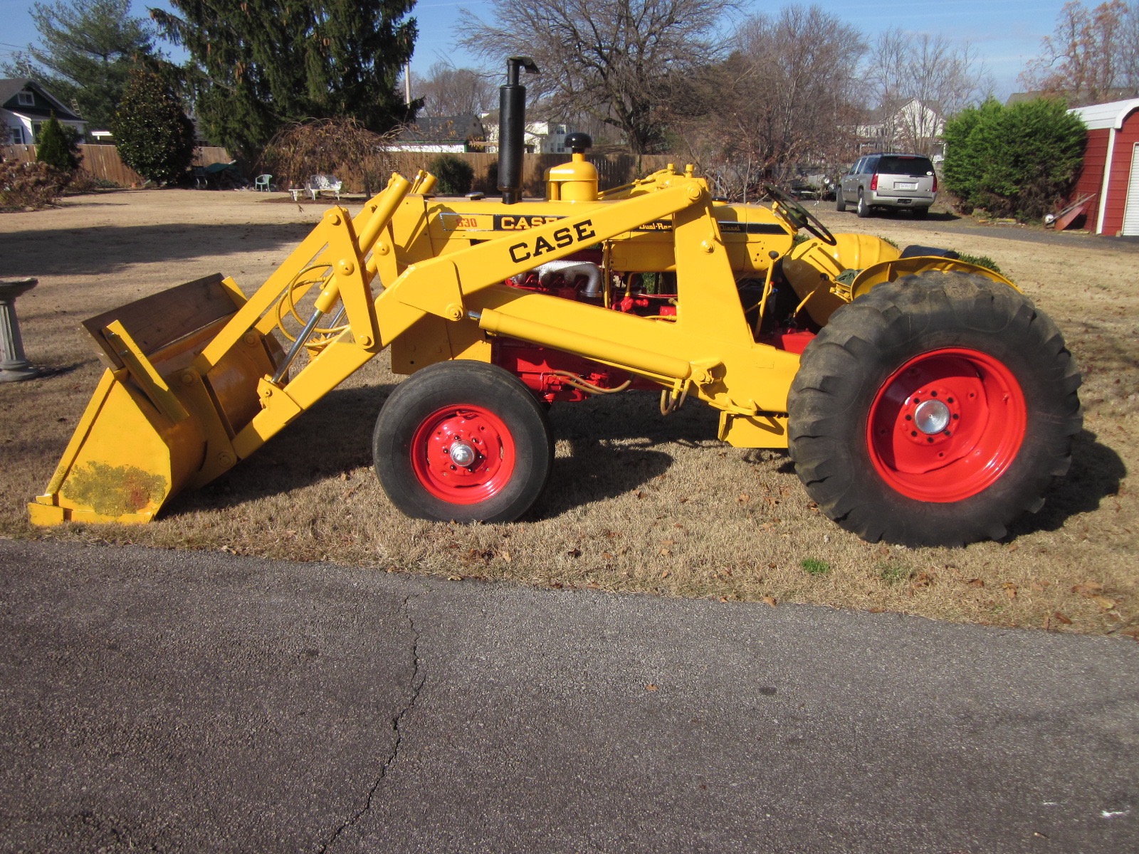

OK, finally got pictures of my neighbors Case, one before, and one after. I had pictures of it when it was finished, but can't find them now, had to wait for him to send one! The pictures are after we took the backhoe off
This was all done with Rustoleum, not the first one I've seen it done with and it seems to hold up pretty danged good! If prepped well, it will level and look great even if done with a brush.
Wire brush all the major rust, you will want to hit that with primer pretty quick to keep it rusting again. Suggest the Rustoleum rusty metal primer, that is what he used. Sand it all with 400 grit, wet sanding is best, prime, then sand with 600 grit, start painting!
Suggest a trip to Harbor Freight for a box or two of their 2" chip brushes, throw them away, don't try to clean them. AND a box of latex gloves, that stuff comes off pretty hard.
George
View attachment 440127View attachment 440127View attachment 440128
George

He sprayed his BTW. Were you planning on spraying? It does yield a better overall job. You can see by the picture he needs to go over where the FEL arms were, and his bucket. He used the industrial rustoleum and cut it with acetone, but I think I said that before. Paint will not adhere to grease, so that particular step is pretty important, especially for the engine.
