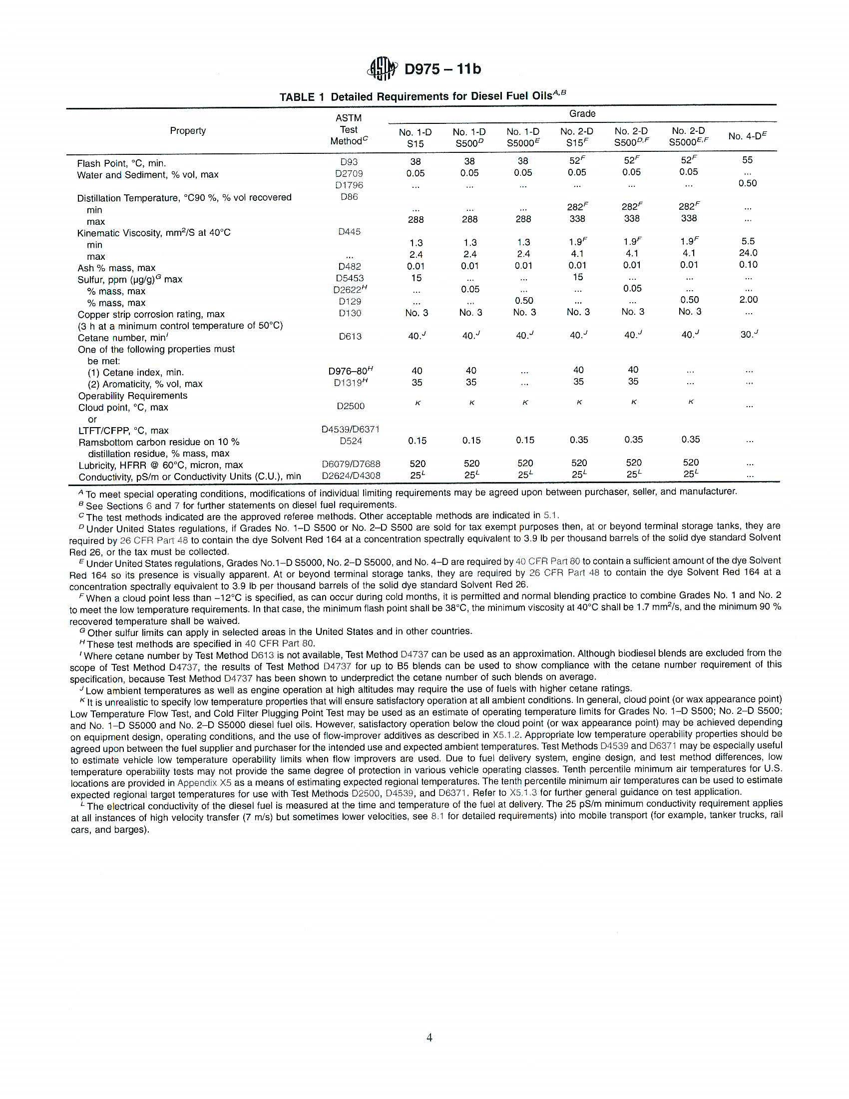

For those who care, attached is the ASTM D975 spec for all diesel fuels, no real difference in the specs. Read notes D and E.
