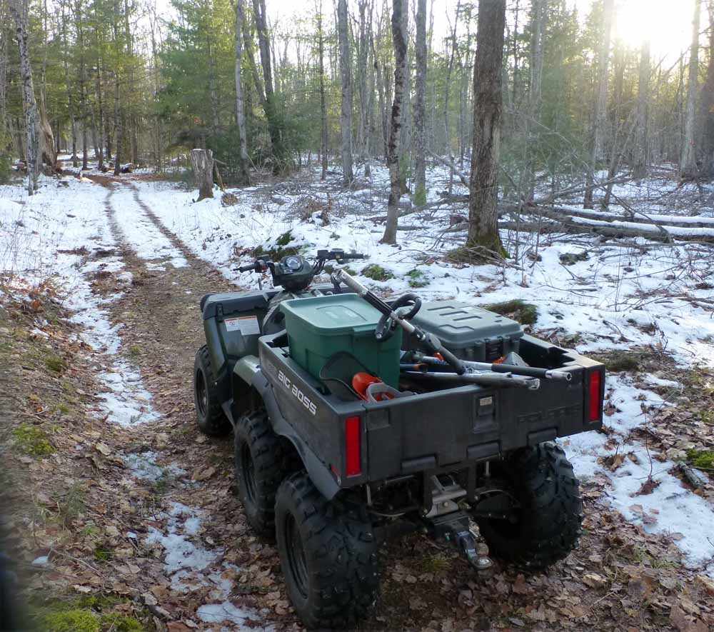

We own a "little" 4wd truck plus a work style atv, and use them both on some of the same trails.
You couldn't drag that 6x6 from our cold, stiff, fingers. No Japanese mini's will be found here.
