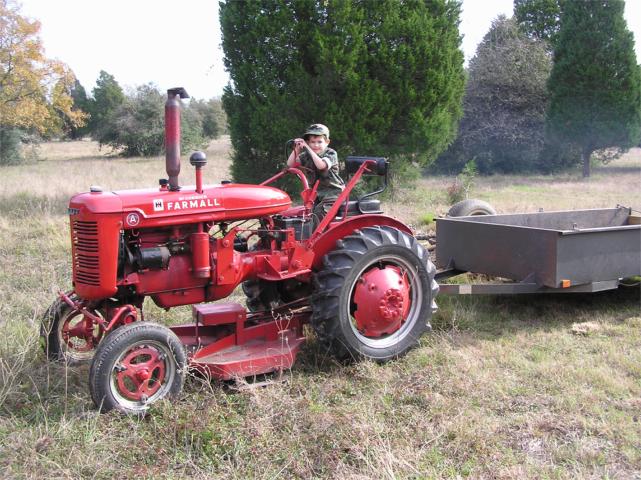

Ortis, My wife's tractor is her Grandpa's 1947 Farmall A (18HP). It has a 4ft belly mower that works great for mowing walking and golf cart trails. I also put a the trailer behind it for people transportation. Here it is pictured with the now famous Eddie Walker's girlfriend's son.
