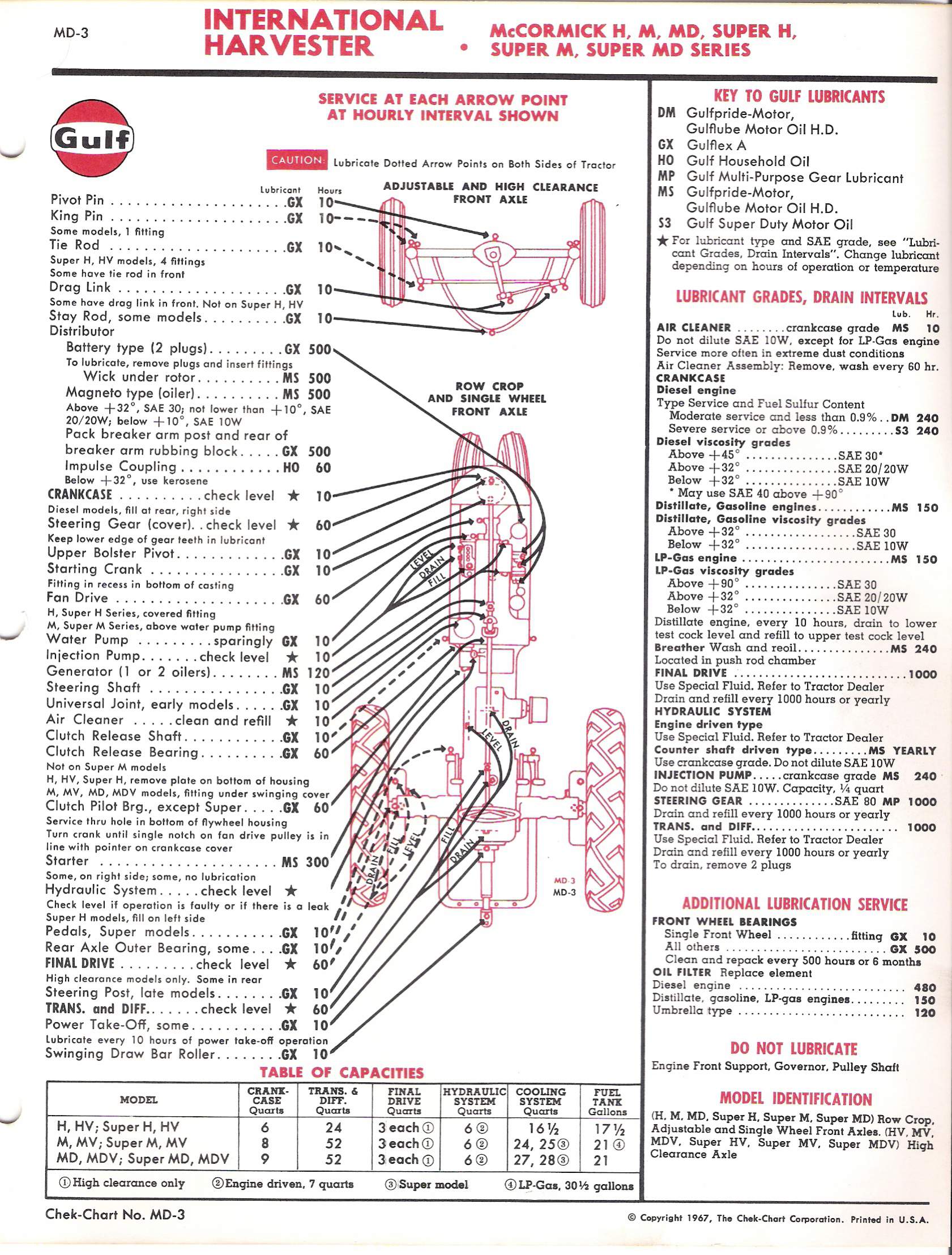

How much lower is your lowest leak below your add oil valve? 1 inch? 6 inches?
   / Farmall M
#33
the lowest leak is at the pto shaft maybe a inch or 2 higher then the add oil plug
   / Farmall M #34
Well then i believe i would save that project till winter since your not going to be pulling it hard. That just me tho.

   / Farmall M #39
If you have a leak out from around the PTO shaft, and not even running, I'm thinking it's way overfilled. Check plug is on the left side, up ahead of the clutch pedal, and should be just below the level of the PTO shaft. Seals are still available through Case/IH. From past experience, I find it best to use OEM seals. I've mashed several cross over part number seals, and learned my lesson.
I've posted a lube chart for your M, should come in handy.... Click on the image, and it will enlarge. Save the picture to a file, and print it off for quick reference.
