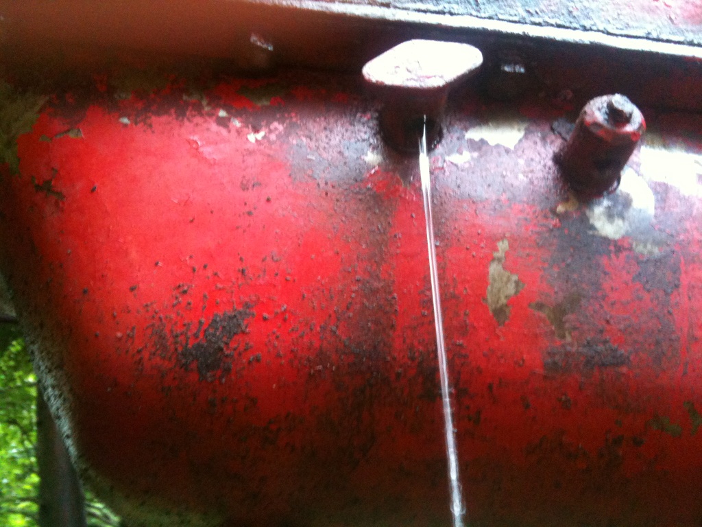

Then with the plugs out and the manifold off, I tried to hand crank the engine. Wouldn't budge. I put some pretty good torque on it, but still nothing.

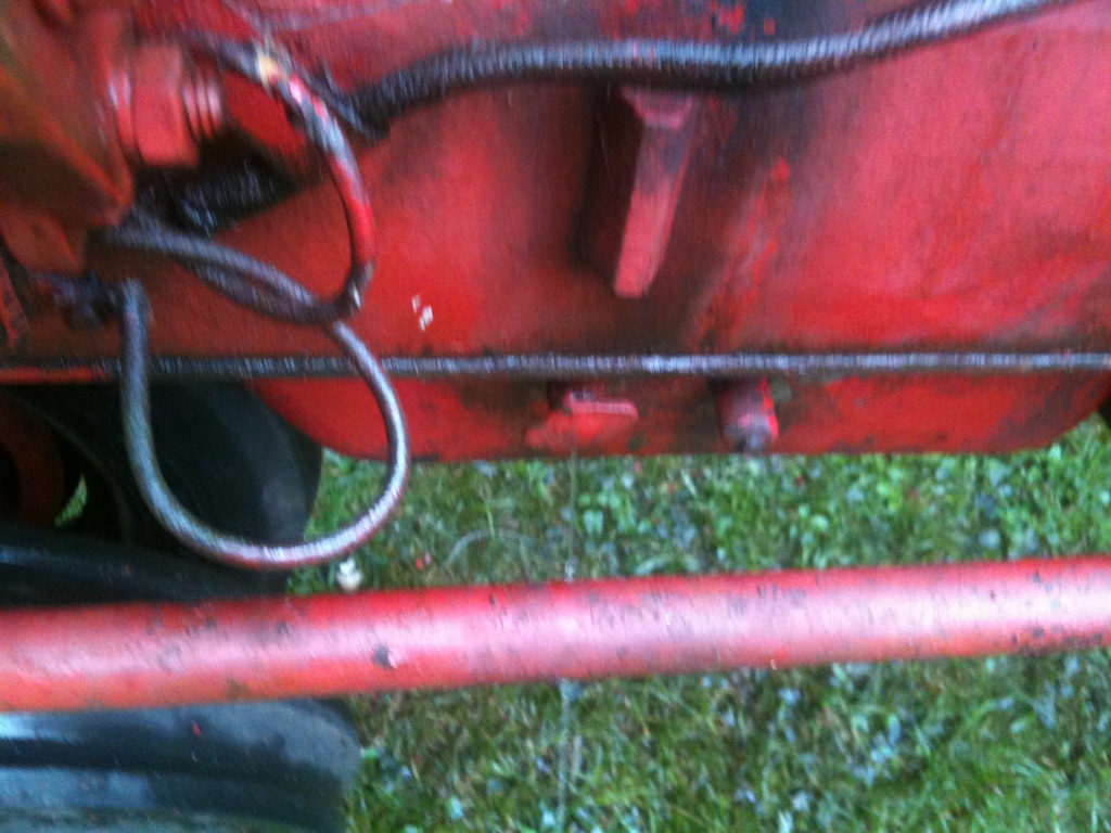

So I figured I had a seized engine and I would check the oil. I couldn't find a dipstick, but found something on the side of the oil pan. This was some kind of plug, and I unscrewed it. Water came from this plug for about 2 minutes. It seemed like a lot of water.
So, what is this plug for ??? Is water supposed to come out of it ???:confused:
I attached a couple pictures.
Tomorrow I'll drain the oil and pull the pan. I don't really want to pull the head if I don't have to, but I'm sure that's where I'm heading next.
Also if anyone has any tips on unsticking a seized motor, I'd appreciate it.

Sounds like you are on the right track. That valve I the picture with water coming out of it is the oil dipstick. You open the plug when you are filling with oil until it runs out, then the oil level is at full. If you take out the lower plug and nothing comes out you need to add more oil as that is the low level. To unstuck a engine I would recommend pulling the head and filling each with a oil of your choice. Next get a block of wood that fits snugly into the cylinder (sits flat across the entire piston head up to the cylinder walls) and every day for probably two weeks give it a hit with a hammer in each cylinder then add more oil. Good luck and have fun. I am sure others have different methods so lets hope they chime in.
/ Farmall Super C Seized Engine #3
If the water is running out the full oil level plug so the pan is full and means the crank oil pump the timing gears main bearings rod bearing have been soaking in water for long time.
This is a easy to repaire engine instead of doing damage plan on rebuild will be doing the same anyways.
ken
/ Farmall Super C Seized Engine #4
With that much water, and your location, I'd guess the sleeves are cracked. Hopefully the block is not cracked. Check the block for an external, horizontal crack, just above the level where the carb attaches to the manifold on both sides. Most I've seen seem to crack on the carb side. Then, when you remove the head, check the block for cracks between the sleeves. I've seen a couple of those too.
ken
yep.. that much watr in the pan.. I'd drop the pan and expect lotsa crank and tg work especially.. wouldn't even try to continue baring it.
might fill the cyls with atf and diesel though. might be able to salvage them jugs and pistons.. maybee not. rings probably toast..
