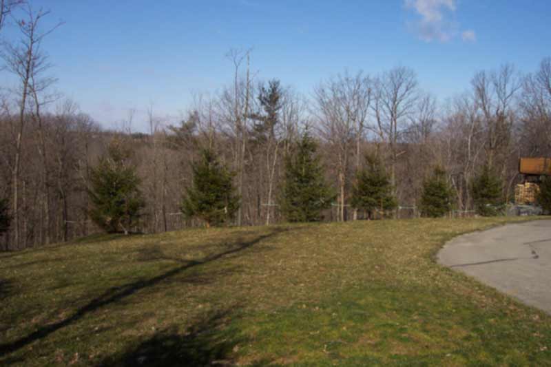

Randy,
I failed to mention that about eight years ago (when I originally thought I'd be building on this property), I planted
about 200 Norway spruce seedlings.
Well, about eight survived and are about 3 - 4' tall. It was a miracle that I even had that many survive because I really didn't know what I was doing. Weeds grew up around these little guys and virtually choked them out.
Hopfully, with care I can coax this survivors into a little faster schedule. Anyway, maybe I should reconsider the Norway?With care, they'll probably grow faster etc.
