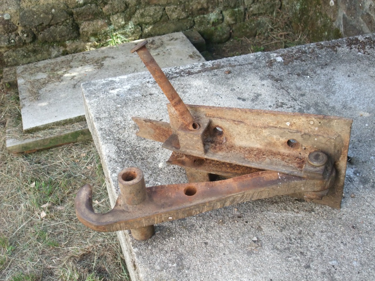

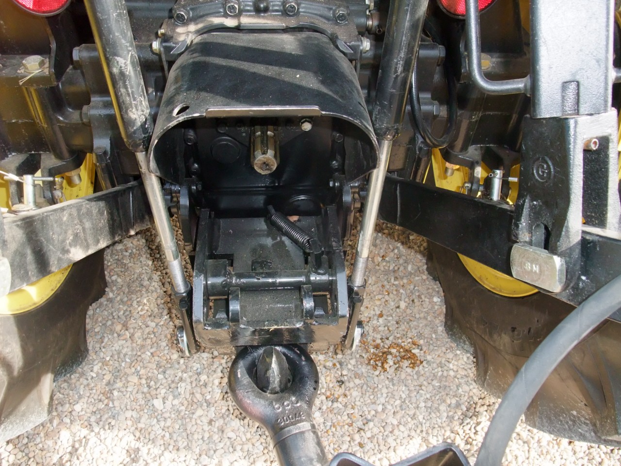

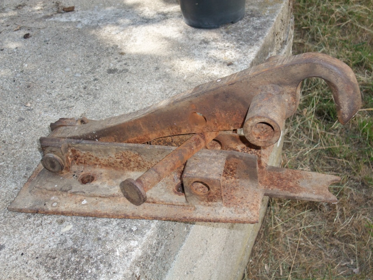

It's a great pity accidents like that still happen. The load must be attached as low as possible and preferably with a real hook designed for the job. Old automatic hook from my Massey 35 and more recent JD 3520 automatic hook.

I like that automatic hook thingie, seems like a good idea, better than a long drawbar tongue on the tractor that slams into the ground to slow or stop a flip.
