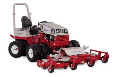

/ What causes tractor rollovers? #5
The local school has one of these.
