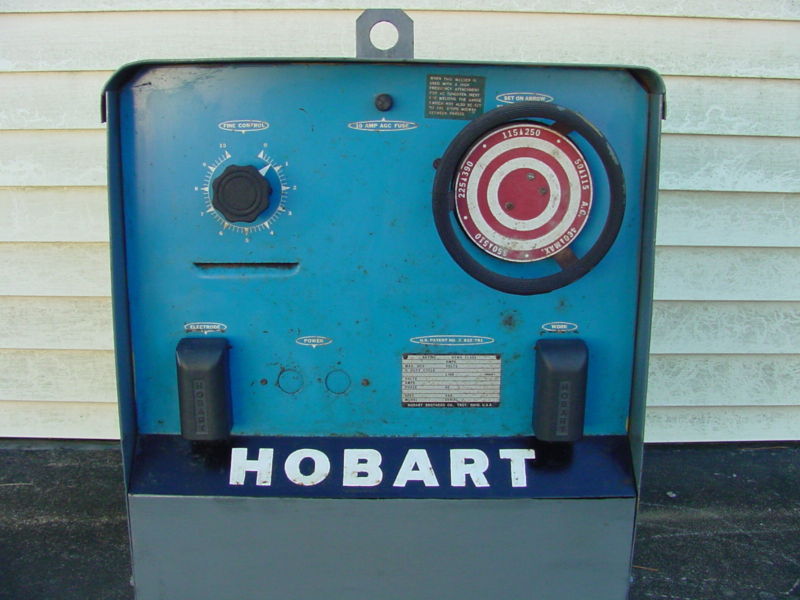

Old pre-ITW industrial Hobart gear often goes CHEAP, by the way, and it's frequently quite stout. Check the MODEL of anything you run into on various welding forums to find out what's good and what ain't.

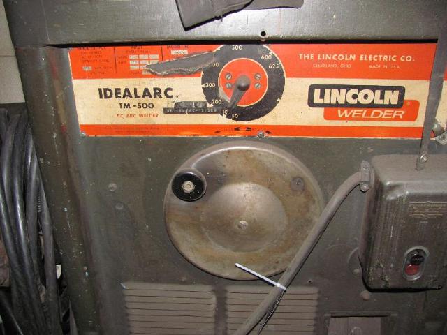

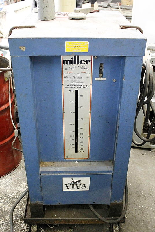

Old AC industrial machines (any major US brand) often have higher OCV (open circuit voltage) than entry-level gear, and plenty of serious work was done with them. They didn't come in 500 and larger amp sizes for no reason. If one fell into my hands for under scrap price I'd at least give it a shot for the educational value. My Miller 340 will run nicely off a 50A breaker though not maxed out. Any of the examples below should also do fine off a (better choice) 100A breaker which I'll add for my setup.
Some little single-phase AC buzz boxes:
The Miller manual was last updated in 1985 and the Lincoln in 1996 so they aren't ancient:

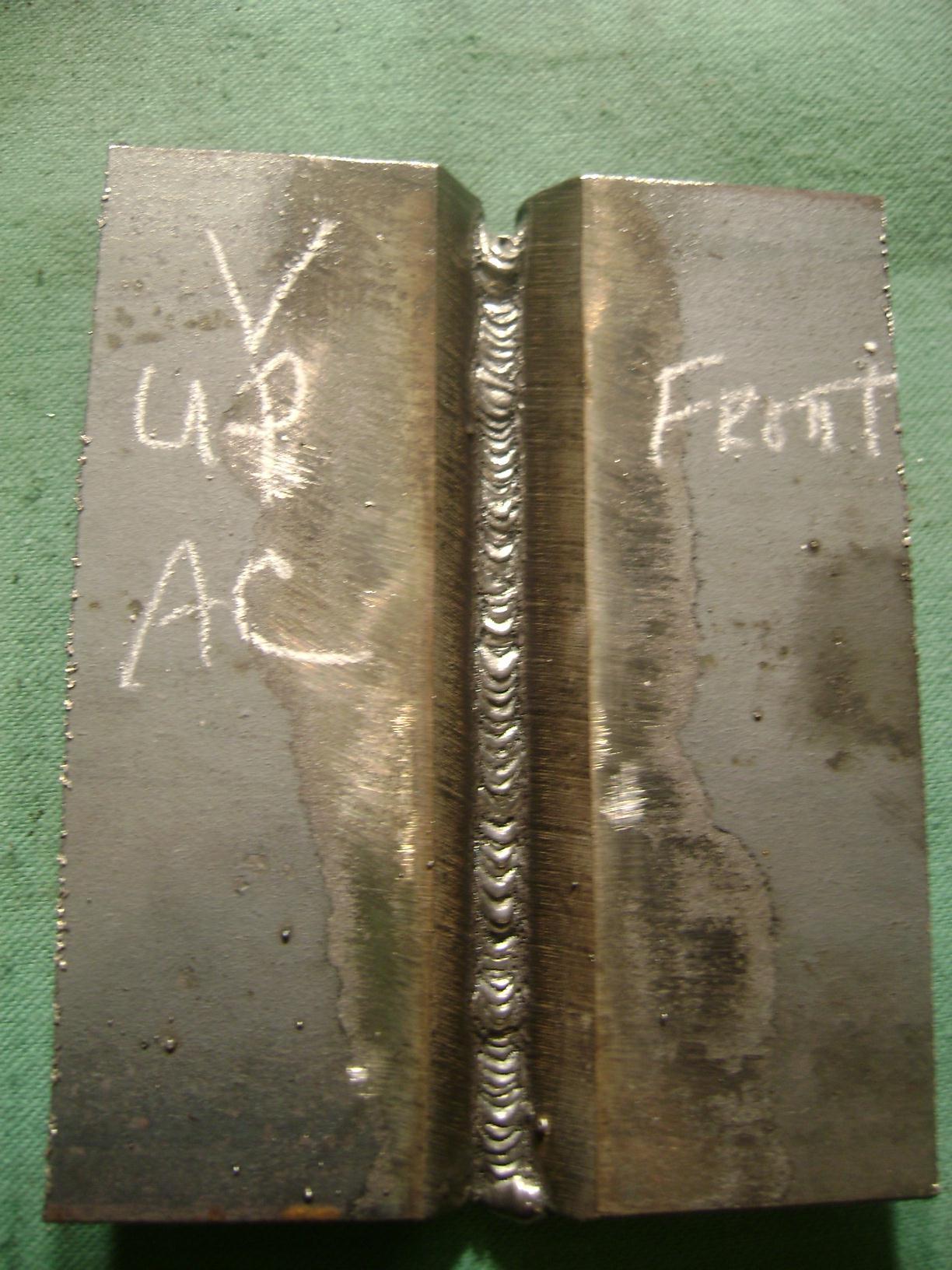

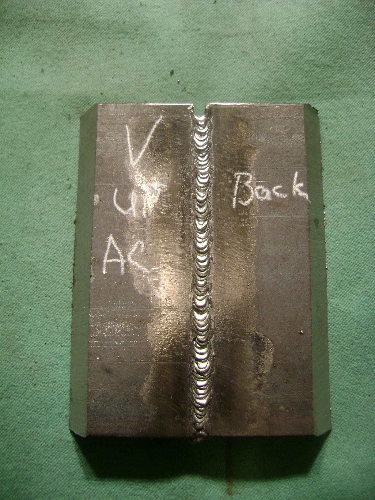

This same discussion came up on another site a year or so ago. Up until then I couldn't honestly say I ever ran SMAW on AC, so I gave it a try. Little open root vertical up with 1/8 inch 6011.

ShieldArc, are you cutting those bevels with your plasma to make those coupons?

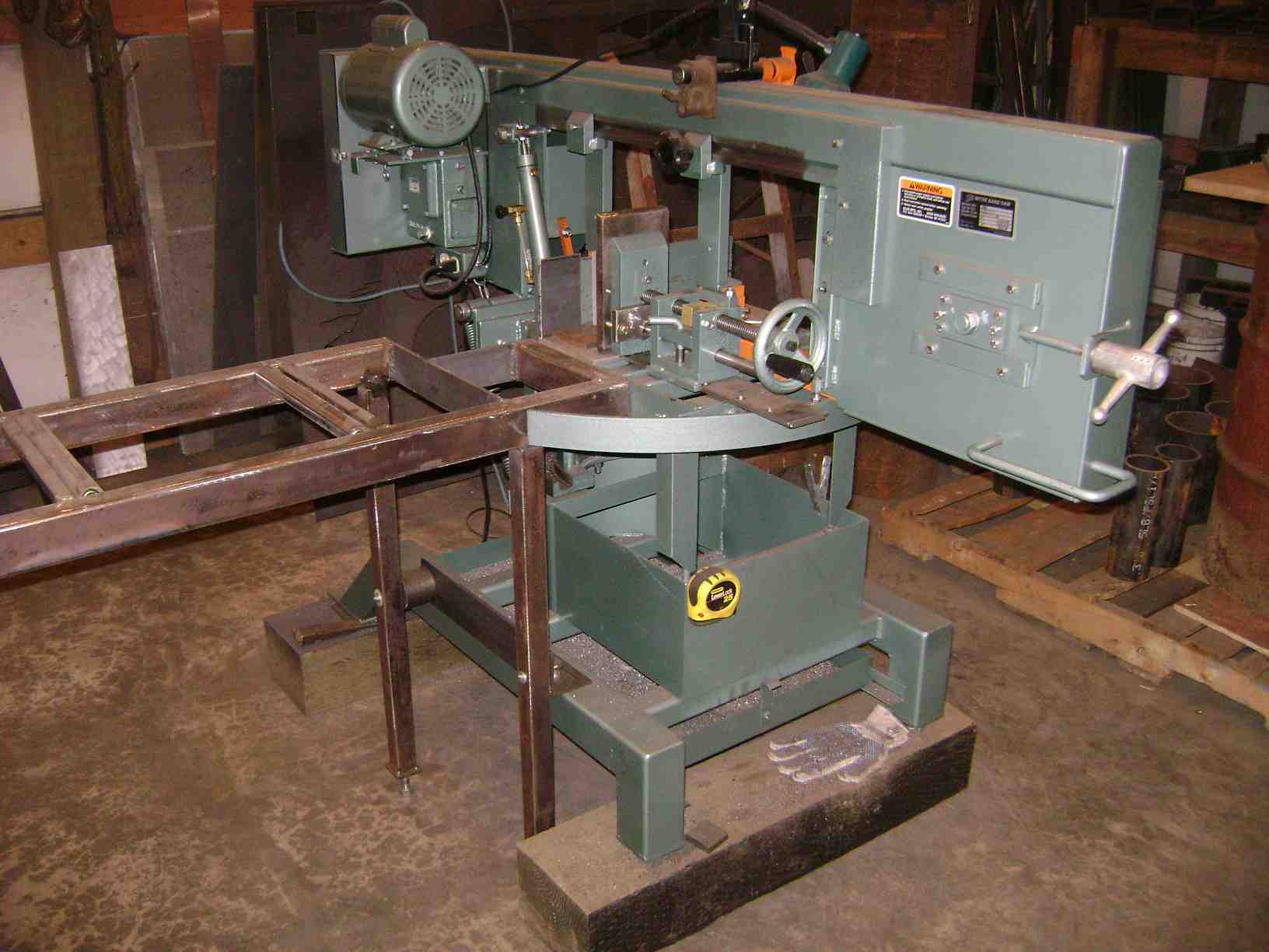

No! That's too much work:laughing:, I use the Ellis bandsaw.

Well, I guess that should do it..
   / favourite stick rod #96
Yeah shes a pretty cool saw, cuts angles really accurate, 50-degrees either way.
