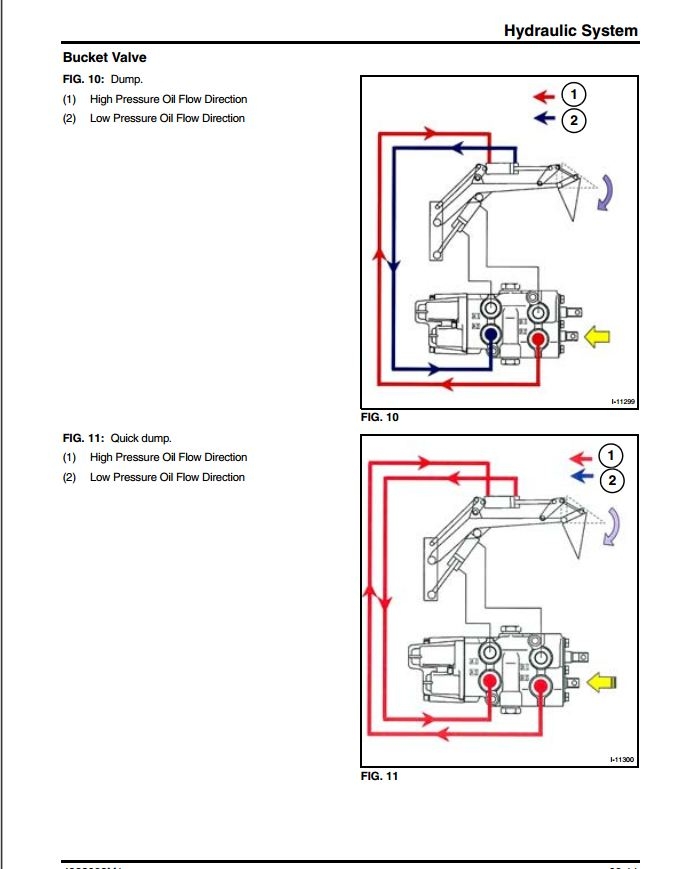

Hey guys first post. I just bought a new 1gc25 TLB last week. Bought the FBX 1574 snow plow. And frame with power angle. Dealer gave it to me in crates. I got done installing everything. It all seems to work. But one weird thing. When I go to angle the blade to the right. It goes right, but as soon as I push the joystick far right, it goes left.
If I switch the lines around. When I angle right (going left on joystick) it doesn't do it. If I angle left (going right on joystick) it doesn't do it.
Before I call the dealer firgure I will make a post. Thanks.

Pushing joystick to far right is potentially regen dump or fast dump. Regen works by connecting pressure to both ends of the cylinder so that oil returning from rod end goes into blind end. This feature will only extend a cylinder so that could explain why it only moved the one direction. Which way is cylinder moving to angle to the right?
/ Fbx 1574 plow question.
This makes sense. So i might have to flip the cylinder around.
Cylinder would be going in. When going right.

No need to try and remount the cylinder, Just don’t push joystick past detent for regen and you won’t have a problem with how it angles.
/ Fbx 1574 plow question. #10
not sure about this brand new gc model but prior models did not have detent.
visual on bucket speed is only indicator.
attached is flow diagram for gc2400, should be similar.
I do not think this should be happening. is this using 1 single cylinder with 2 hoses for angle? could not tell for sure.
Yes 1 cylinder with 2 hoses.
