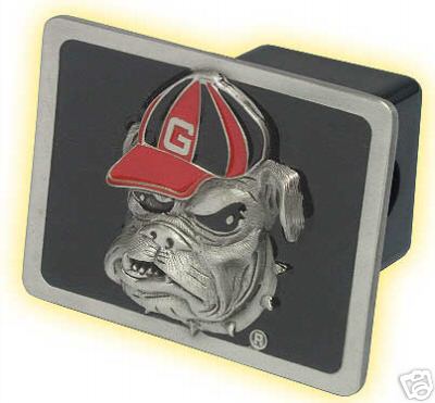

I also much prefer the Bulldog style.
I would modify the hitch if that is an option and have them put a bulldog hitch on it. I dont know anyone that has regretted getting a bulldog but I know several who have regretted not having one.
Thanks for the feedback.
I assume your not talking about this bulldog hitch pictured here. :D
I googled bulldog hitches and found a few pics, etc but I am not really grasping the concept and why it's better than a standard ball hitch receiver. Is it more secure? easier to align? Do I need anything special on the truck side?

It allows the truck and trailer articulate more without binding. A standard ball and hitch will only articulate a little over 15 deg or so before binding. Not a big deal unless you drive over some rough off road terrain.

I find them easier to hook up and latch then other types, but it's not a big deal.
Bulldog Hammerblow trailer hitch ball couplers
davkir's website shows what I am talking about. They do not have to have anything special on the truck side it hooks up to a ball hitch. I find they are a lot easier to hook up and less likely to have problems getting them to go on over the ball. I think they hold better. I believe that if you look at bumper pull trailers that haul livestock you will see most if not all of them with bulldog hitches. I was told that was mandatory to have bulldog style hitches on the livestock trailers but I dont know that for a fact. In my opinion for what it is worth. They are not that much more money when you order it with a new trailer and I think they work quite a bit better.
