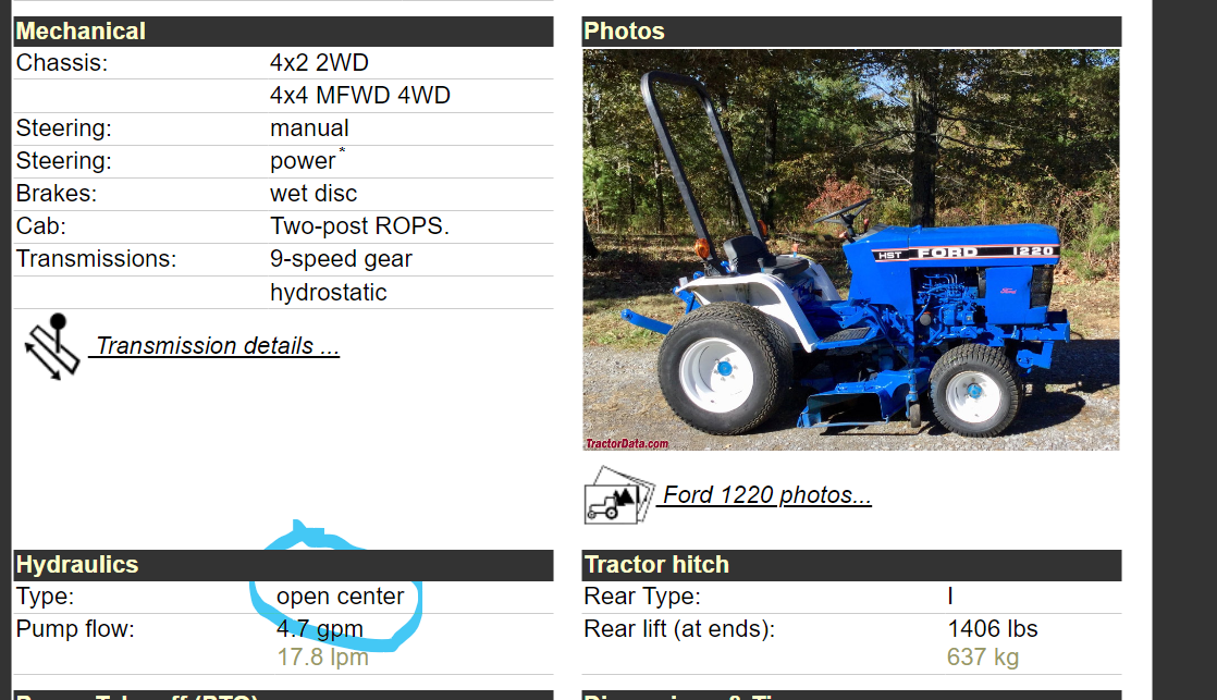

Viewing Tractordata confirms what other members stated that your Ford 1220 has open-center hyd system.

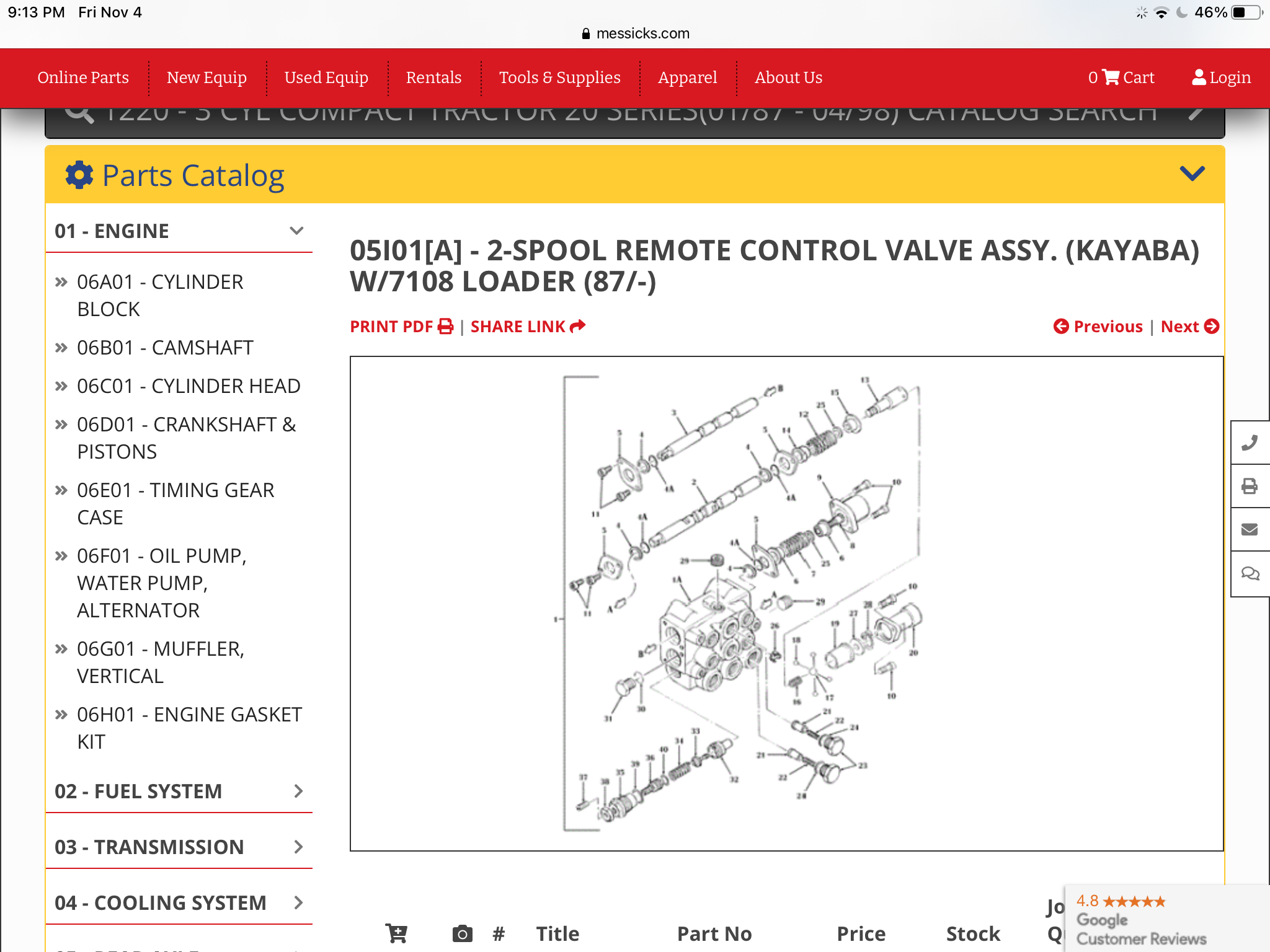

It could be a Zexel or Kayaba valve. Diagrams are found in the Ford New Holland 1220 hydraulics section. The tractor year is later, but could be an earlier valve.
