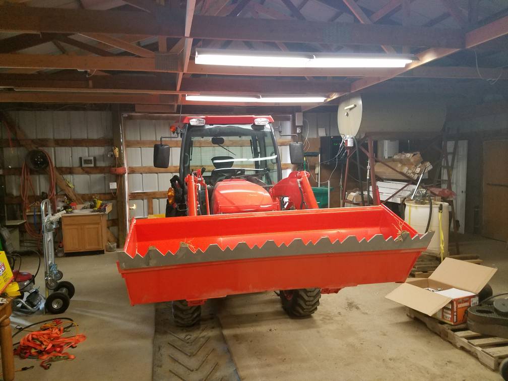

I'm happy with mine. Works decent for grabbing brush. Works good for breaking up dirt when "digging", not that a loader can dig well. Protects the bucket edge really well & doesnt interfere with back dragging much. 20161207_104352.jpeg

I bought a Tooth bar for the bucket on my B2150 and it works wonders when pulling up tree stumps. It grabs the roots fairly well..... certainly something a plain bucket edge can't do.
And I have a LOT of rock on my property so it helps when doing any sort of digging.
The other little addition I had the dealer do, was weld on a couple of small chain "Hooks".
An absolute necessity when I have that piece if equipment or item I need to lift to move.
I can wrap or connect a chain to my generator and secure the link(s) to the hooks and lift away.
So easy.
