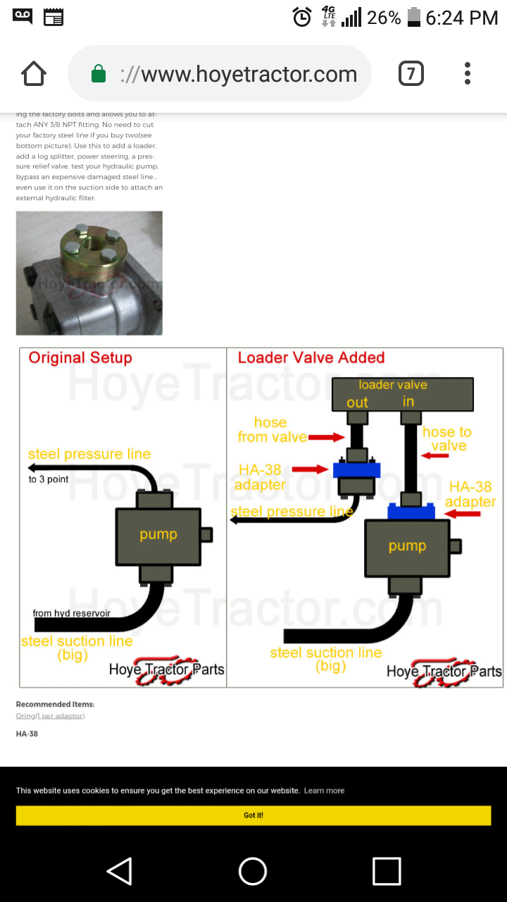

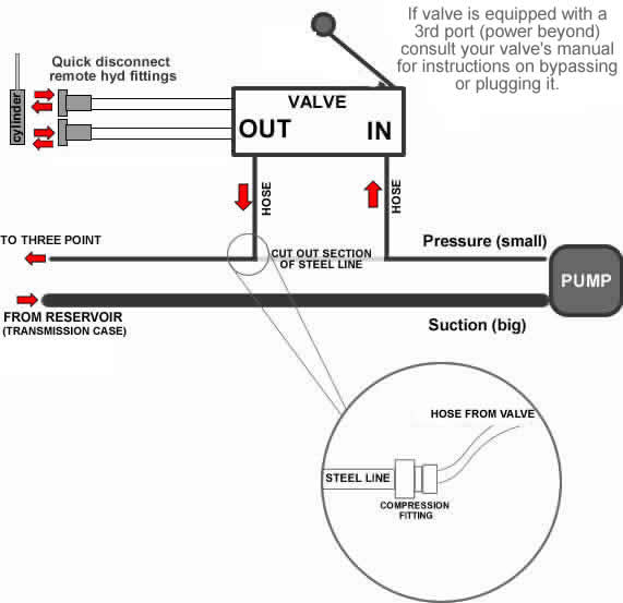

The new valve should have 3 ports. Pump, tank, and power beyond. Tank would be a third line that returns the low pressure oil to tank/reservoir. The tank port is typically only rated for a few hundred PSI, so if you try to feed another downstream valve (like your 3 point) from the tank port, you can damage the valve.
/ FEL Build Questions.
#23
That may work if you have clearance.
So this is what I found.
But your saying use the PB port and then have a return, got it. :thumbsup:
And the adapter just keeps me from cutting the steel line which I like.
You guys are all a wealth of information I really appreciate it.

There exists an adapter for aux hydraulic circuit that is factory made.
A member "Bill" has duplicated them and he is usually on this site.
Pricy per say but not really out of line considering.
It mounts left rear in the 3 point area.
(have the OEM on my CUT) and use it for my log splitter.
The other option is another hydraulic pump driven off of the crankshaft pulley (as I have done). Again there was a factory adapter to do this.
Advantage is that the factory pump is somewhat slow for FEL usage and I used a larger volume pump making my FEL a pleasure to use.

I love the idea of using a separate pump and hydraulic system for the loader then I don't have to worry about cutting into my current system and damaging my three-point or starving the transmission or anything. I saw a bit about a front PTO in the manual I didn't delve into it very much. Can you provide some more information Insight on that please?

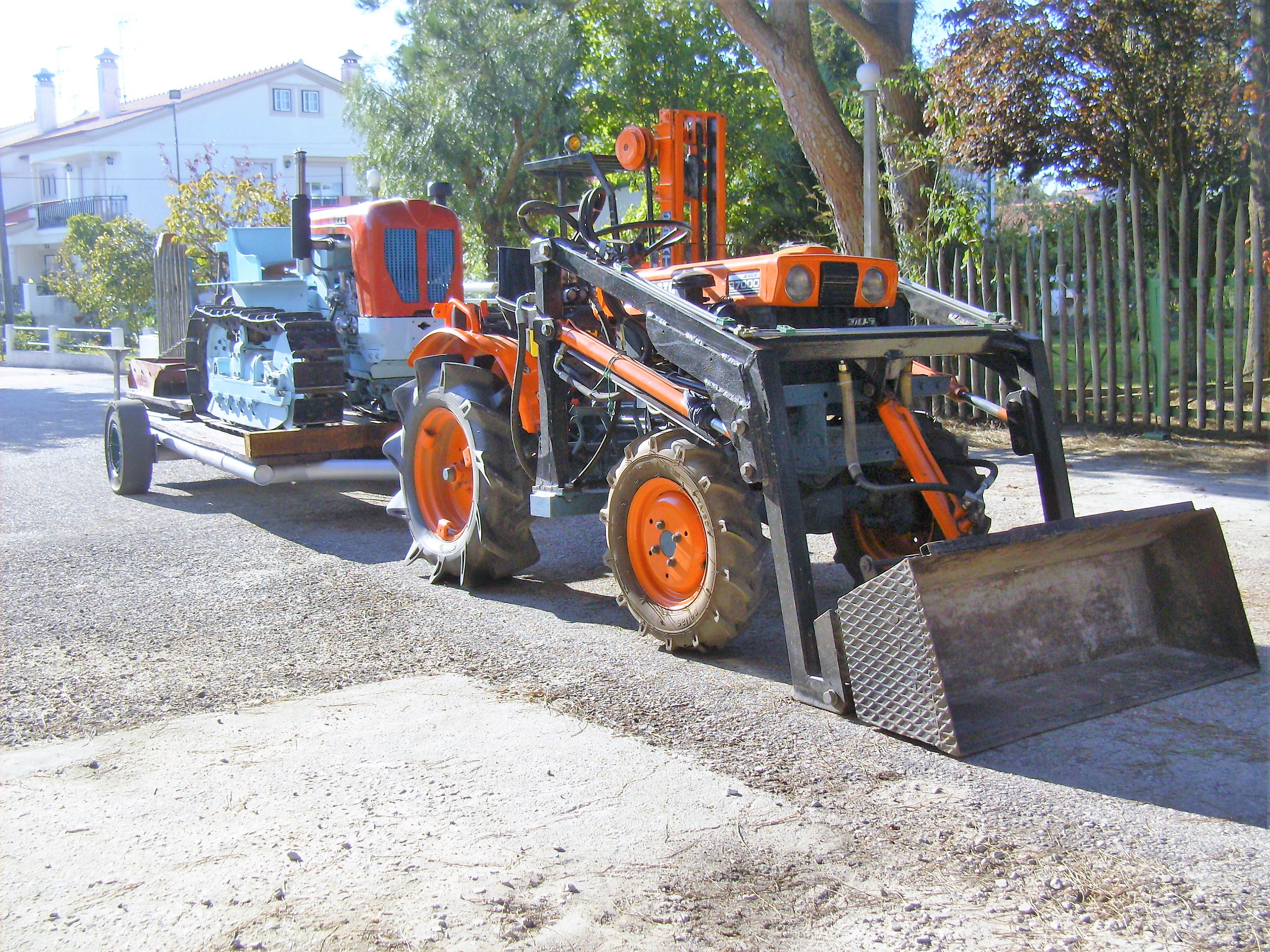

So a few minutes with the calipers and my brother is going to make me the adapters that mount at the pump.
Tomorrow I hope to finish the subframe.

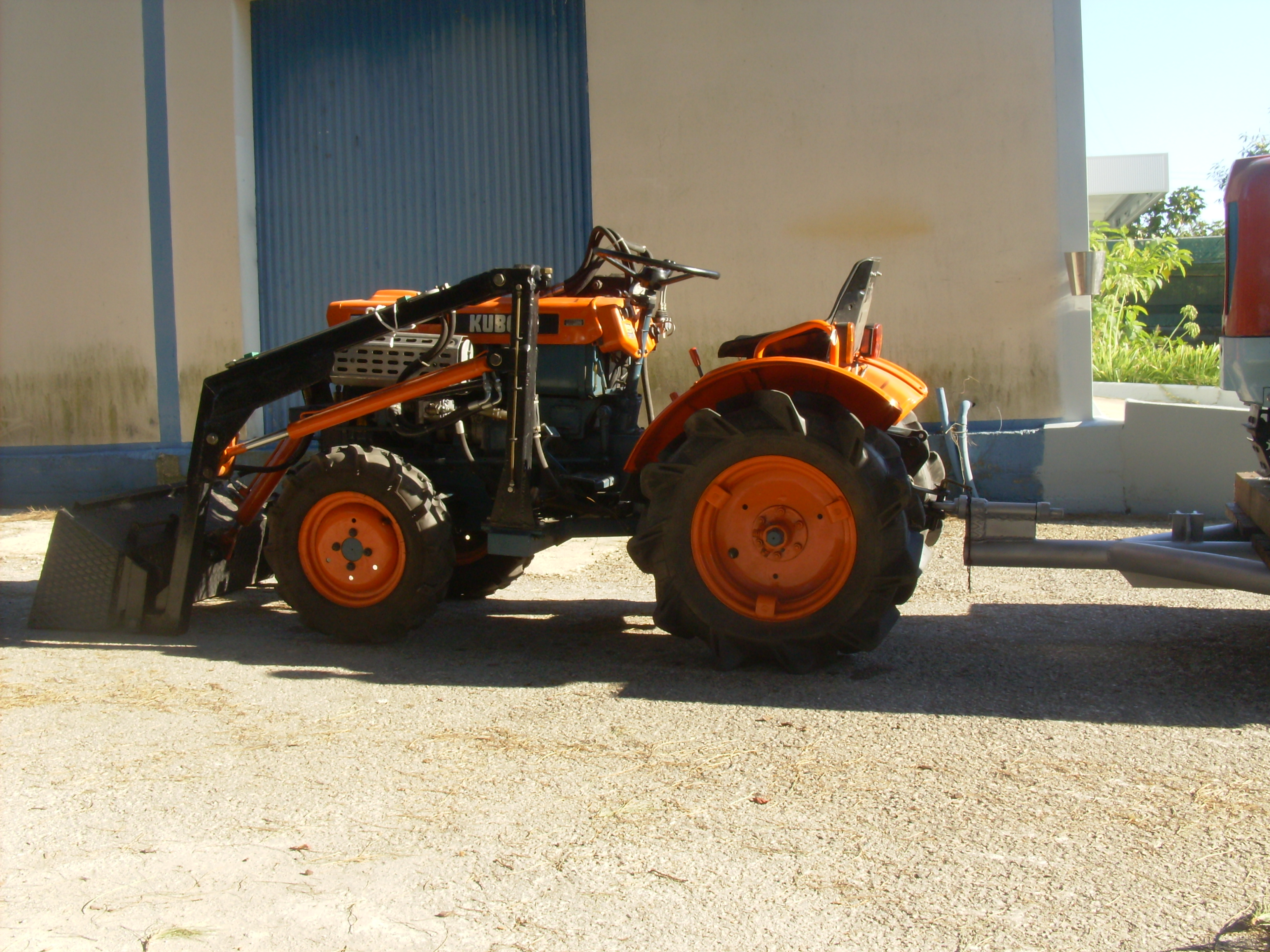

A few years ago, I built a loader for a Kubota B7000 I had at the time.
I also went with the separate pump/reservoir solution. It allowed me to use a slightly bigger pump to make things go faster, while also not messing with the tractor's hydraulics as they're not designed to handle a loader.
I machined a pulley that would fit right after the main crank pulley, then just mounted the pump on the side of the engine and run a belt to it.

Well works sucked so slow progress. Here is in progress and completed subframe.
And my brother got the adapter done.

So I got the front bumper and supports made.
The questions I am pondering is should I close the ends on these things? The bottom main beam and uprights? I was planning not to simply so they couldn't hold water.
The other question was bushings. I see some each way is there a need for them really?
