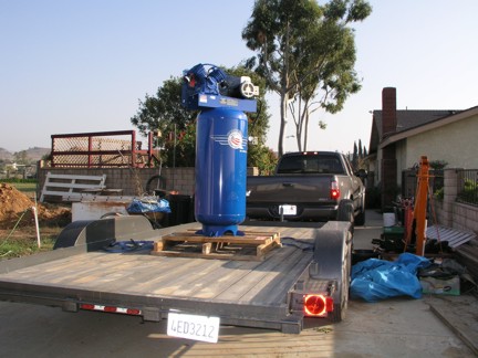

Many thx to Madreferee for his plans and help. Trip to local steel yard snared the 3x1.5 bar channel for $20, had everything else. I reduced the overall size just slightly to save a few pounds for my bota BX22. Also added some clamp pads as Madreferee suggested in his plans, with a welded nut to enable removal of the clamp bolt.
Good workout for my Miller 175, using .030 wire with 75/25 gas. Finished the forks off with POR15 grey followed by POR15 black top coat. Took me a day to do all the cutting, welding, then coating.
Did some testing today for bucket capacity using the forks with a pallet. Able to lift about 400lbs with my BX, about what I figured given the 460lbs spec. First job will be to remove 400lbs vertical compressor from trailer and place in barn/workshop.

First (BIG) test of the clamp ons - lifting a 450lbs vertical compressor off my trailer and moving it into my barn/workshop. Equally big test of my BX22 which was up to the task.

Moving it to the barn. These clamp-on forks already paid for themselves, saving me $100 delivery charge on the compressor. Folks, thats nearly 500lbs in the air which probably doesn't impress most of you with bigger tracs, but it impressed my neighbor who owns a Deere 410 backhoe.
