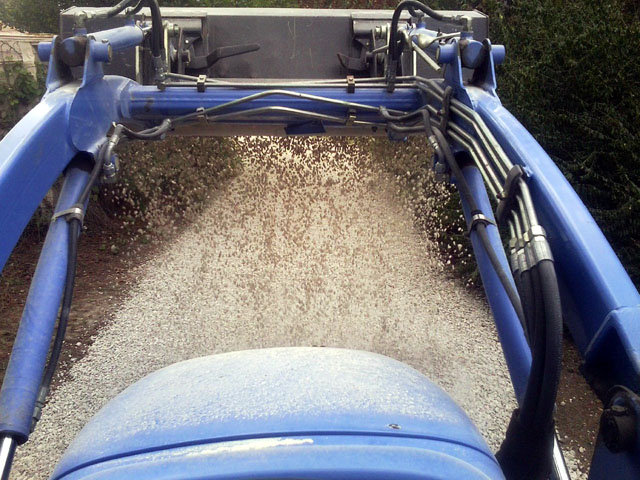

An earlier thread ("alt/sand box for the driveway")describes a system where the FEL is partially blocked off to control sand distribution. It is not discussed if it is a good idea to use the FEL as a giant salt shaker. I like this idea but I have about 150ft that needs to be sanded and I don't want to abuse my equipment (Kubota L3200).
/ FEL for sand spreading #2
I have spread salt and sand with a FEL. It requires skill and lots of practice. It also depends on how "flowable" the material is.
I isn't easy, BUT you can do it. Think of getting the dump angle of the bucket to just the point where materiel starts to flow as you creep forward (HST transmission much preferred) as the material starts to flow, you must curl up slightly or you will get a "wad" of material on the roadway. Then continue shaking the joystick like a man with severe palsy. You will continue as you start to lower the dump angle again to keep the flow rate even as you match the creep rate forward. I told you this wasn't easy didn't I? :) Anyway this is an advanced bucket manipulation technique, and it might take some practice to get it down. Keep adjusting/shaking/creeping until you get the desired results. It would be much easier to show you than tell you.:)

James has it. Slow or fast, this is an excellent bucket skill to master. I have no need to spread salt (Thank God), but this is the method I use to place gravel toppings on driveways. Here's a pretty good video showing the shake and bake method. Skid Steer Spreading Driveway Gravel - YouTube
/ FEL for sand spreading #5
Yep, that's it. He made it look pretty easy.. I suspect he does it nearly every day. I don't do it that often, and I have to get into the groove again each time.

I sprinkle bone dry sand from the FEL bucket sometimes too. If it comes out too quick you can always back drag later and spread it around. It doesn't take much sand to get traction so I would err on the side of too little rather than pile it on. You can always add more but extra doesn't scoop up very easy. :D

The OP didn't ask how to do it, but asked if it was a good idea to do it (they don't want to abuse the their equipment). I think going through the shake process could be abusive with a full bucket, but with a partial bucket, and for only 150' of drive, it would be fine.

It is not going to hurt the L3200.
Once again, I agree. 3000 hrs of commercial work on my tractor. I've hurt it doing a lot of things it was never designed for, but this isn't one of them.

When making my sons drive way we had a load of base brought in and the driver dumped it all in one spot instead of spreading it. I just used the bucket to drag it back a little at a time when it was done it looked great, and the driving back and forth set it in nicely.
