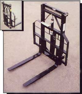

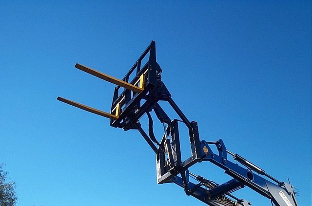

Got a new attachment project in the works. Need an extra foot or so extra lift on the Massey 1742 fel. Not quite enough height to place pallets in the old barn loft. Old dairy barn, low ceiling, great loft for storage. Picked up a ssqa plate. Will fab up a short hydraulic lift system, like a fork lift onto the plate. Doesn't need to lift much, 5-600 lbs. Has anyone seen or have such an item?
/ FEL forklift #2
I saw such a device or more speciically a loader with an extra section some years ago at a show. It was either HORST, HLA or FREY.

I have not seen a forklift on a FEL but have seen 3 point mounted fork lift masts for doing what you are describing

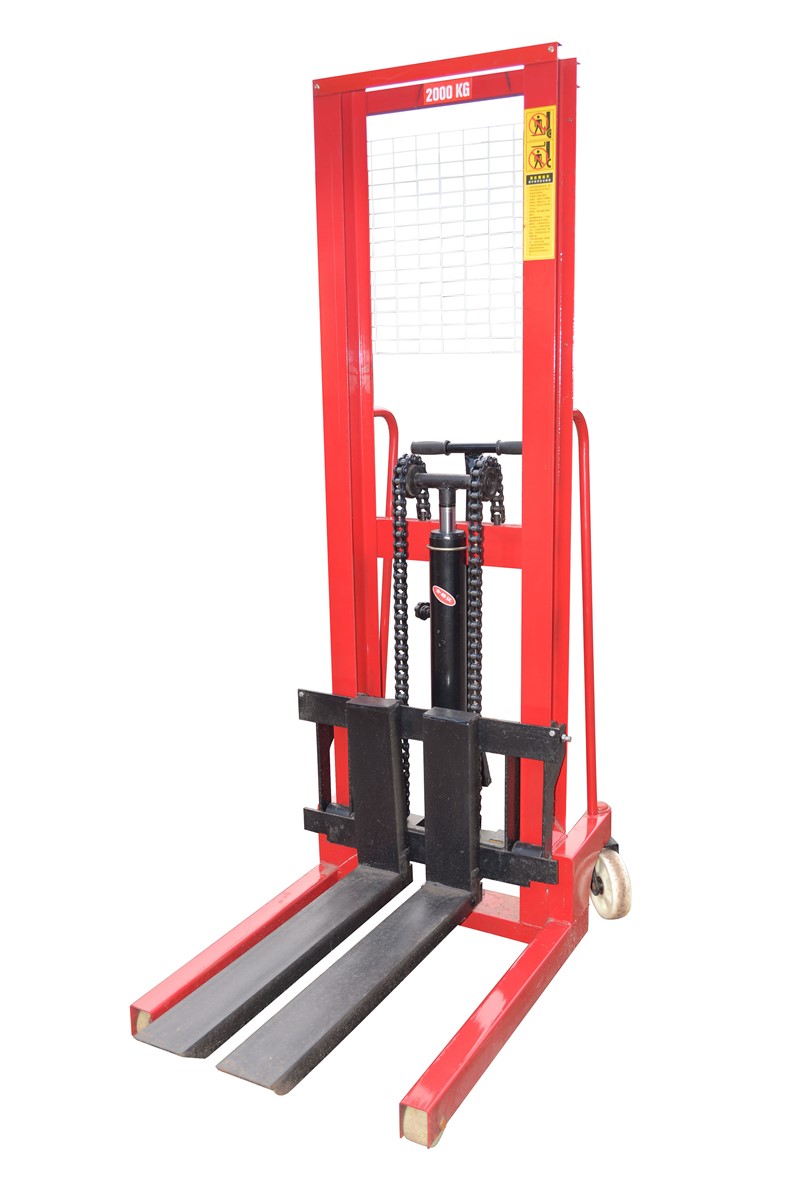

Yes I have. Probably here on TBN.
You could start with this style: manual hydraulic stacker - Google Search
Or a small 3 point forklift welded to the attachment plate: tractor 3-point forklift attachment - Google Search
Then there is this style: Extra Lift
Pictures from an image search

That looks kind of scary and fragile.
Having forks at height can subject them to great stress when you pull up or push down without realizing it. A FEL is not a forklift.

Fork lift forks on a loader is done a fair amount, but like was said, you have to be VERY careful when using them...

Looking at the three point units, prob be overkill, too heavy.
