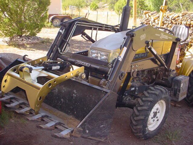

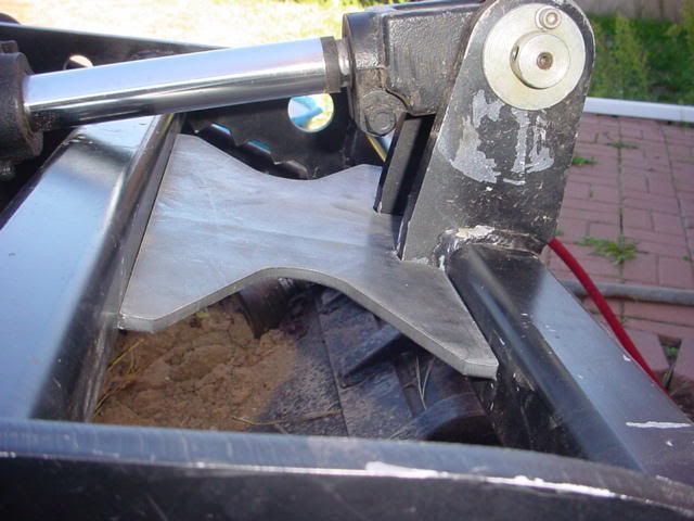

Well sice this thread sort of came back to life, I just realized I forgot to post pics of the cylinder rod protector plate after I welded it on:
Not only will this protect the cylinder rod from odd shaped rocks protruding through, it stiffens up the jaw assembly to protect against bending.
Larry
   / FEL Grapple from Scratch W/ Lots-O-Pics
#112

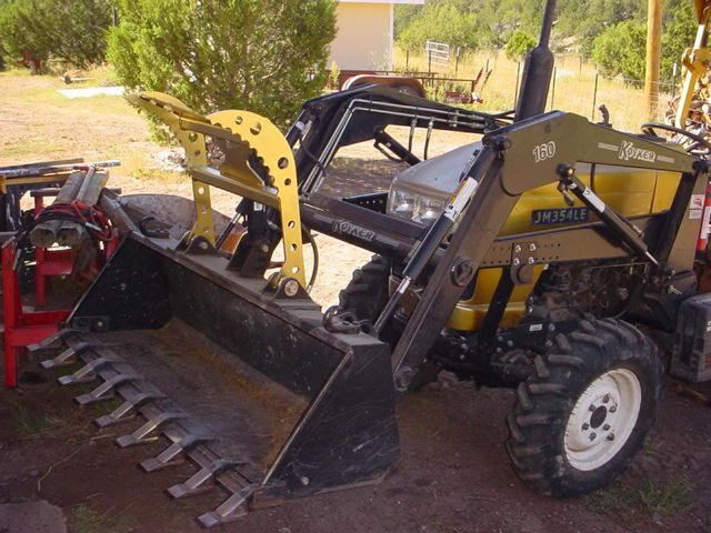

I found some close matching gold metallic spray paint at home depot. I figured as long as welding on the plate burned the original paint job, I would paint it gold to match my tractor just to see what it looked like -
I think it looks OK, not to many have a gold metallic paint job on a tractor. It's kind a cool looking in person and in full sunlight.
Hum....After looking at these pictures and thinking a little, I may have come up with one more very simple idea. It will solve a little problem most people have when they install a grapple. A hint - you loose it because the cylinder takes it's place. Anyone venture to guess what I'm thinking? It should be an easy guess, the answer is on the bucket in the above pictures.
Larry

Larry awesome job on the grapple! Like the new color as well. Will it blind you in the sunlight? Oh you aren't missing that hook you took off the middle of the bucket? Thanks for sharing betcha you got almost as much time into posting as you did in building "The Grapple" -Ed
#114
Ed,
Yep you guessed it, you win the bubble gum cigar! I have some weld on grab hooks. When it warms up a little I'll MIG a few on the plate between the jaws.
- No doubt, It's got to be a close tie.
Thanks Ed
Larry
