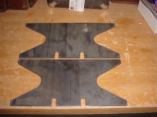

I got the Cylinder protector plates plasma cut Friday. Have not installed them yet, been busy cutting firewood. Maybe this weekend before I go up the new road to collect all the stumps with the grapple.
I had two made, one for me and one for a buddy. I got to get me one of those plasma cutters. It goes through steel like the proverbial hot knife through butter.
Rob,
They came out great (as usual) thanks for drawing them up, no surprise it fits perfect.
Thanks again,
Larry
   / FEL Grapple from Scratch W/ Lots-O-Pics #106
You are welcome.
They look pretty good too. I'm thinking Ken should be happy with all the stuff you've done for him.
