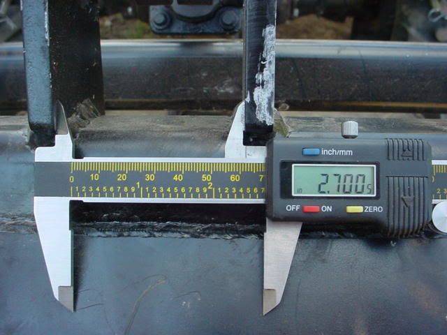

I too am interested in the clamping/welding issues. Looking at the "front" mount for the hydraulic cylinder, the supports are welded onto two sides of a box-section - surely you got some heat-related bending of this, even if small ?
I have been trying to weld short sections of the total joint to reduce bending, but my welds never look as nice as when it is a continuous bead. And clamped the steel box section still has some "spring" in it, such that when the clamps come off it is (slightly) bent.
I am also interested in the support backing bar on the bucket - it stops short of going all the way to the main "braces" that connect to the arms of the tractor - would it have been stronger taking the load to the main brace, not leaving the stress-riser at the corner of the thicker plate welded to the thinner bucket plate ?
John,
I just went out & took some measurements just for you ! :)
Below are two pictures, the one on the left is the inside width of that front cylinder bracket you mentioned, the one on the right is the inside width at the top of the bracket. As the caliper shows 2.7005" on bottom & 2.7000" on top, so yes, I got .0005" of warp, or I was not perfectly square when I clamped it prior to welding, OR the paint is a little thicker at the bottom due to "sagging" :eek:
Yes it would have been stronger and allot heavier too. Rob & I opted to go the light weight route so as to not diminish the lift capacity by all that much. The whole assembly (everything, pins, cylinder, jaws, brackets, plates, etc) weighs ~ 125 pounds. There is a 32" long X 4" wide X 1/2" thick reinforcement plate welded to the back of the bucket as well. The front top edge of the bucket is rolled over & welded so it's plenty stiff.
