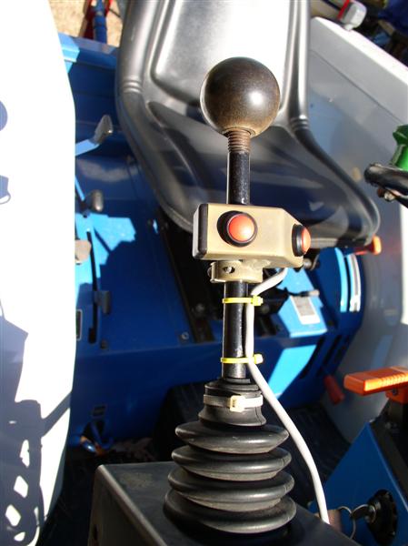

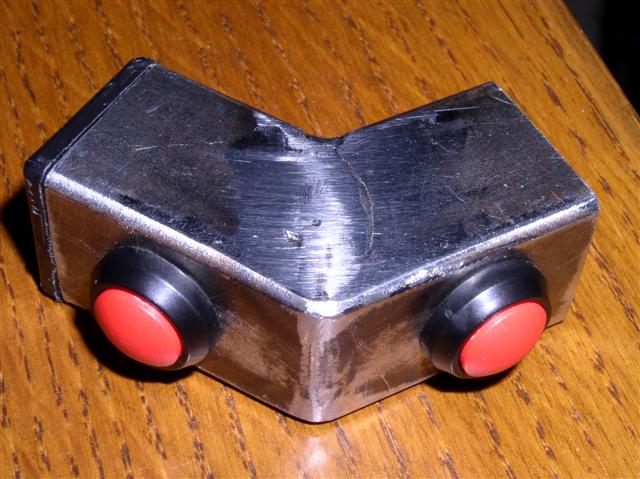

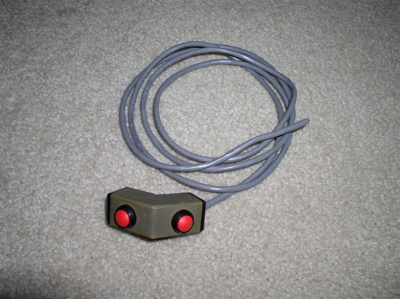

I've got a couple of extra switch housing left over if you want one. I'ts just 1x1x0.070 tube cut and folded and welded and zinc palted. I needed a switch I could use with work gloves on. I don't have any of the PB switches but they are available from ITW about 5.00/ea.

Thats a mighty fine switch assembly you fabricated. Thanks for the generous offer. I ordered that two button joystick handle on page one of this thread, so I should be all set. Thank you much!

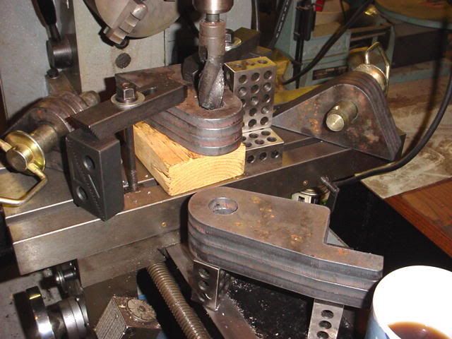

After stacking similar brackets four at a time, I went through them with a 1" drill bit. The plasma cuts have a taper, so this had to be done to true up the holes.

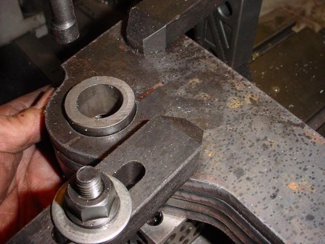

After completing the 1" holes, it was time to stack the jaws, then index them to center. The holes in the jaws are 1.5" dia so that a piece of 1.0" ID x 1.5" OD, DOM - Drawn Over Mandrel (seamless tubing) can be inserted then welded in place. This is a feature that Rob engineered into the jaw hinges to improve strength.

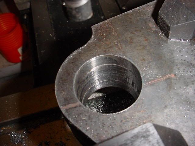

The 1.5" holes in the jaws will be bored out with a ....boring bar. I've never done this before, I consulted Rob about this he said to "index" on the center - whatever that means, then go as slow as possible, so here goes:
Well not too bad they came out all right and nothing broke, so I guess I done good?

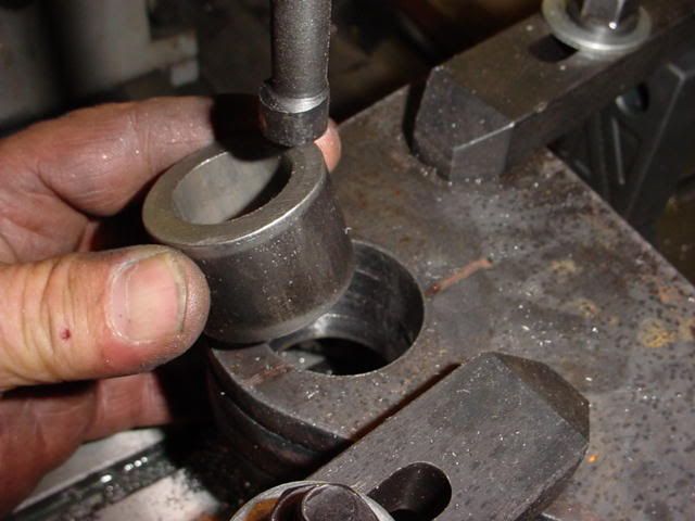

It took several passes, increasing the cut diameter a little at a time for each cut till I got close to test fit the DOM:
It fits, I was hoping for a press fit but will have to settle for a slip fit. Not a problem as I have an idea how to clamp them into position for welding.
