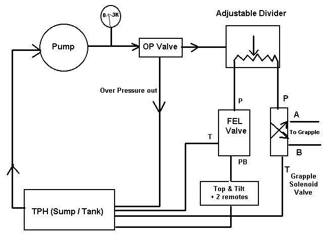

I am intrigued with your use of the variable volume flow control. It appears you have a solenoid single selector valve in the inlet circuit to the flow control. Is that to insert it into the circuit only when the grapple is activated? A description (or even better, a diagram) of the circuit would be most appreciated.
Again, you are to be commended on a most professional job.
Farmerford - thank you for the compliments and your question.
The electric Solenoid which operates the grapple is attached to the Excess flow output of the variable divider. Here is a basic hydraulic schematic of the system. The diagram is in simple terms that are (hopefully) easy to understand.
Click on image for full size:
I also have Top & Tilt Tilt (TTT) plus two remotes, basically the entire circuit is in series (except the grapple - it's down stream off one end of the Divider). When I'm not using the grapple, I can adjust the divider for max flow through the FEL valve if I want / need more flow. Flow is not a problem though, as I have ~ 9.5 GPM available at rated RPM.

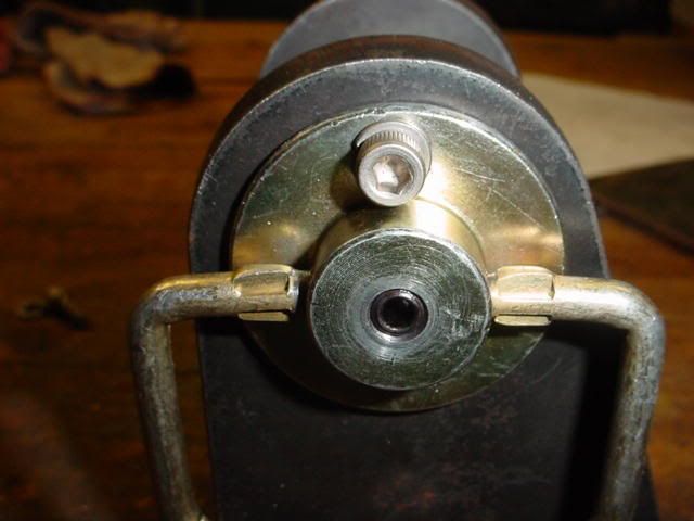

I figured as long as I made those fancy grease-able pivot pins I better lock them in place so the pins won't rotate inside the brackets.
First was to drill through the pin shoulder & bracket:
Then tap the hole:
Then screw in a stainless steel socket head cap screw (SHCS)
The screw is only 1/2" long so it's flush with the other side of the bracket:
OK so now the pins will be "locked" in place, no rotating, no falling out, no lynch pins, no retainer chains & hey I can remove the handles too. This will make it nice and clean - nothing that anything can catch on.

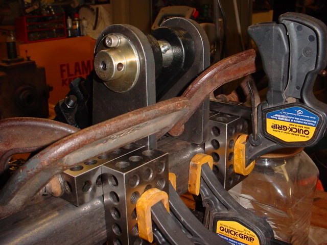

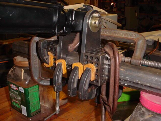

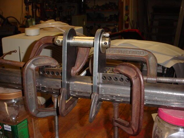

I hope to do some welding soon, so better get busy clamping things together. 1-2-3 blocks came in real handy to get the cylinder mount bracket nice and square onto the 2" square cross tube:
After using a few clamps to get the blocks square to the tube, a few more clamps were used to clamp the brackets to the block:
Once everything was square and tightened down, all but the essential clamps & 1-2-3 blocks were removed:
I welded the front cylinder bracket to the 2" square x 1/4" wall cross tube.
It came out nice and square and just enough room to fit the cylinder clevis without binding.
