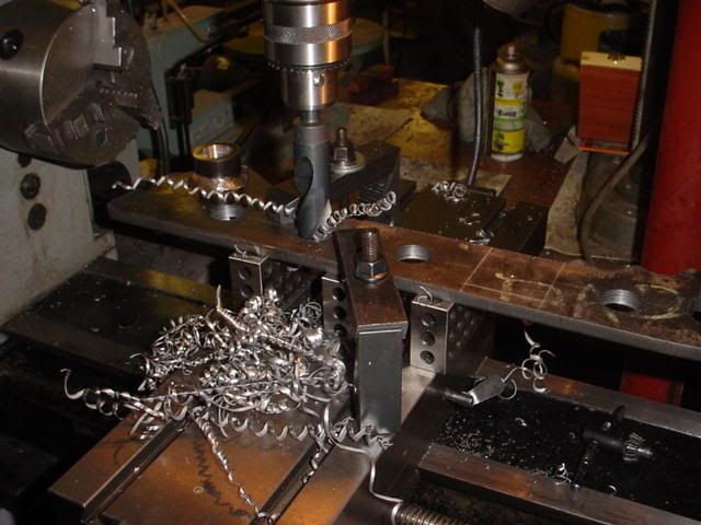

I also have another problem with the grapple project, In the picture there wasn't enough of the mill drill lathe combo so we could know what kind of machine you have guess I'll just have to guess. Congratulations on another fine project, thanks for sharing with us and it is always good to see the different tools and what they are capable of.
Toy,
The Mill Drill / lathe combo is one of those "controversial" units I purchased on sale for practically nothing. It actually works pretty good for my needs. This is what it looks like - except the color of mine is gray:
Thanks for the compliments on our grapple project.
Larry

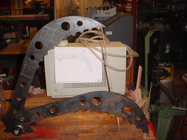

Well sice this thread sort of came back to life, I just realized I forgot to post pics of the cylinder rod protector plate after I welded it on:
Not only will this protect the cylinder rod from odd shaped rocks protruding through, it stiffens up the jaw assembly to protect against bending.
Larry

I found some close matching gold metallic spray paint at home depot. I figured as long as welding on the plate burned the original paint job, I would paint it gold to match my tractor just to see what it looked like -
I think it looks OK, not to many have a gold metallic paint job on a tractor. It's kind a cool looking in person and in full sunlight.

Larry awesome job on the grapple! Like the new color as well. Will it blind you in the sunlight? Oh you aren't missing that hook you took off the middle of the bucket? Thanks for sharing betcha you got almost as much time into posting as you did in building "The Grapple" -Ed
   / FEL Grapple from Scratch W/ Lots-O-Pics
#114
Ed,
Yep you guessed it, you win the bubble gum cigar! I have some weld on grab hooks. When it warms up a little I'll MIG a few on the plate between the jaws.
- No doubt, It's got to be a close tie.
Thanks Ed
Larry
