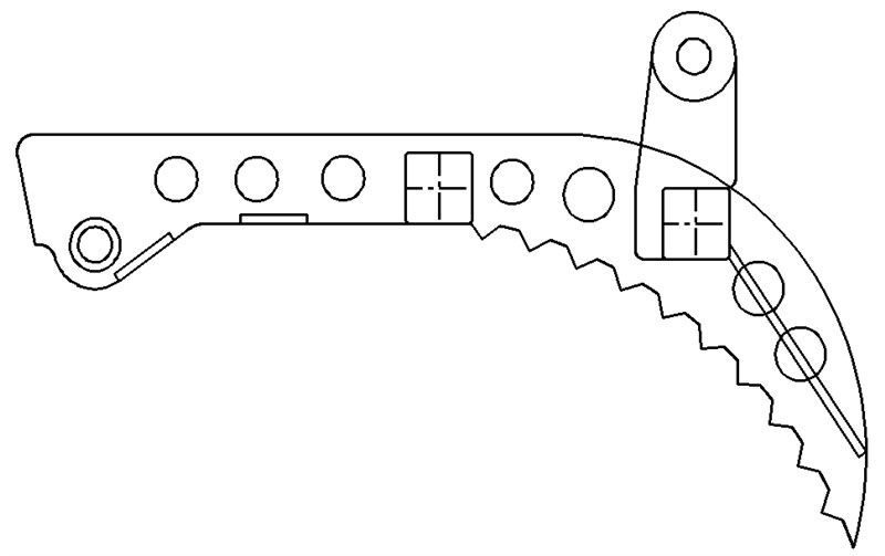

3RRL said:
Larry,
One last thing...
I thought of drilling a few "lightning holes" in the grapple jaws themselves to remove some weight but not strength. They are not necessary nor will they affect the strength of the jaws. So if you are interested call me. They are like the holes in your 1-2-3 blocks, except I would make them リ1-1/2" and リ1-1/4" in front and behind where the pivot tube connects to the jaws...space equally.
Something like this:
I don't think you need them at all, that's why I didn't draw them in the first place. But thought I'd throw it out there to make the jaws "look" even more high tech before you welded them. On the other hand, I did not want to detract from the traditional rural grapple look either ...the choice is yours.
You are doing a terrific job. I have a feeling your grapple project will turn out great. I'm so glad you like the design.
Oh WOW Rob - that is just too cool looking. Well that helps me out allot, now I know what I'll be up to next - Spending hours drilling holes that the plasma cutter could have done in about 10 seconds. Thanks :rolleyes: The way I see it, I have no choice but to put those lightning holes in. I must be the first on the block to have those!
Larry
